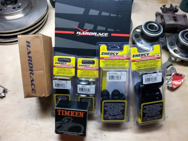

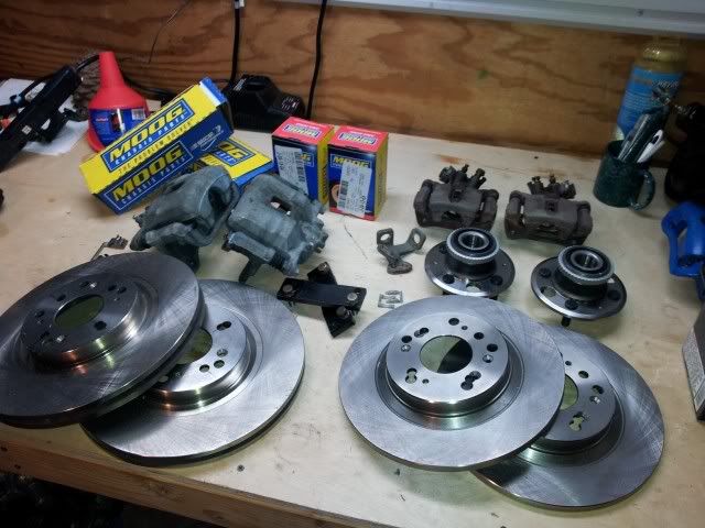

Most of the brake parts for the S2K Conversion are finally in. Just need pads, SS brake lines and front wheel bearings
Going to run Axxis Ult's front and rear.
Andy is up to invoice 632, and i'm 641, so hoping I will have my coilovers in the next couple weeks. Just bought a F7 brace from him and he was awesome enough to have it powdercoated black for me (not a bling bling kinda guy haha). The F7 brace is made out of a stronger aluminum than the ASR brace, so the extra 40$ or whatever it is makes it well worth it.
Hardrace bushing kit is also ordered as well as rear hardrace endlinks. Whatever the hardrace kit didn't cover I bought from energy suspension. Couldn't find any aftermarket front endlinks besides ES for the front on the EX front lower control arm, and I wanted to stick to the 22mm front sway bar so I'm just going to have to pray that the ES ones don't squeak. Moog do make front endlinks but I was told after Federal Mogul bought them out that they were no good. Despite this I still bought their outer tie rod ends and ball joints.

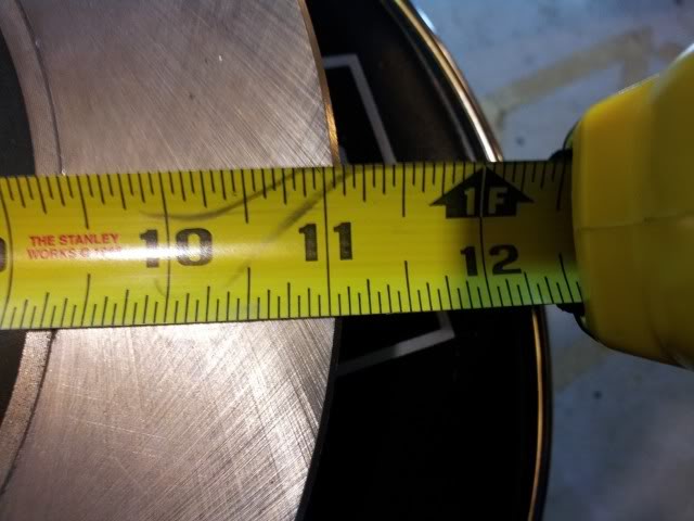

EP3 rotors are only 10.3" S2K rotors are 11.1" BrakeExpert (mike) provided me instructions for the rear install of the S2K rotors. He actually might have the DIY up on here or H-T.
What the crap? S2000 rear rotors are 11.1"?
Old Jul 3, 2012
  #57
Zeferint's Avatar
Autocross Padawan
Joined: Aug 2009
Posts: 601
From: CT
Rep Power: 212
Zeferint is a glorious beacon of lightZeferint is a glorious beacon of lightZeferint is a glorious beacon of lightZeferint is a glorious beacon of lightZeferint is a glorious beacon of lightZeferint is a glorious beacon of lightZeferint is a glorious beacon of light
Re: Zef's EK "Weekend Warrior" Build Thread!
Yep!

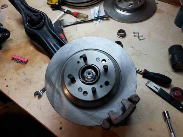

The trailing arms are ASSSSSEMBLED! ..well, except for pads and brake lines.
Nothing is torqued down to spec yet.
Thanks to BrakeExpert for CNC'ing the bracket to make this possible.
Still no official ETA on the coilovers yet. Wednesday will make it 2 months since the order date, but I have no doubts that they will be well worth the wait.
