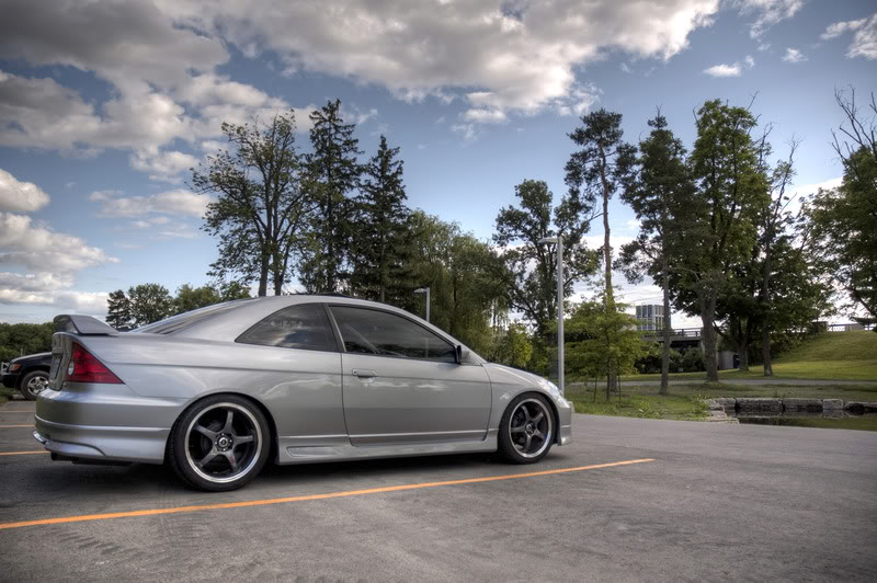

18x8
get 215/35/18 if you go 18s... im on 225/40 and it makes your car sit slightly higher off the ground since its bigger than stock tire specs.. and i basically have no wheel gap.. front almost slightly tucks.. and rear tucks when even just 1 passenger in rear
