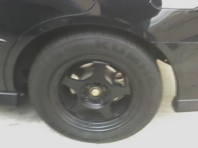

I finished my rear disc swap last night it took me about 1.5hrs. All i have is this crappy phone pic right now but i want to take some better ones soon. Also i had no problem useing Ep3 e-brake lines only one braket didn't line up.

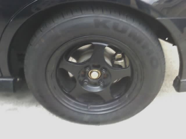

Two more

That’s eerie I got mine picked up for 250 with newish Hawk HPS in them also. It took me about an hour and a half, with a buddy helping hold stuff. Also mine came with ep3 lower control arms. Then I bled all four lines. The rear discs have a way better pedal feel, not mushy like drums, and they grab allot better. Right now i am running the stock proportioning valve (non-abs LX) and they stop great, i have been pushing them allot the past two days. Soon I am going to get wilwood adjustable proportioning valve so I can get every last bit of braking power out of them.

you can make the last bracket work. bolt it in and bend it to where you need it.
