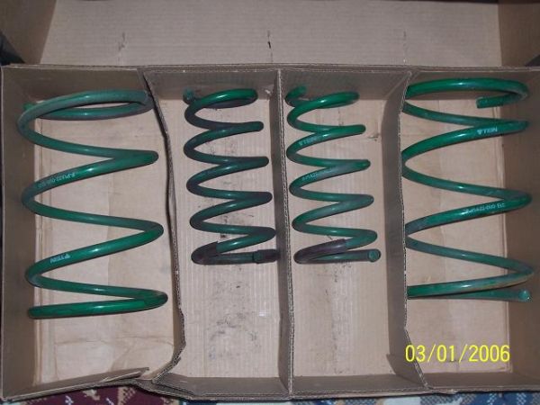

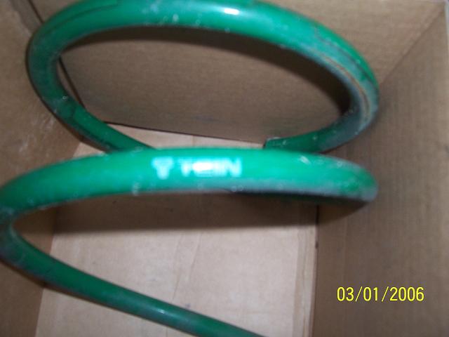

ok, i finally picked up my s techs. they are a little dirty, and show signs of use, but they are still nice. and i only paid 66 bucks for them, so its well worth it

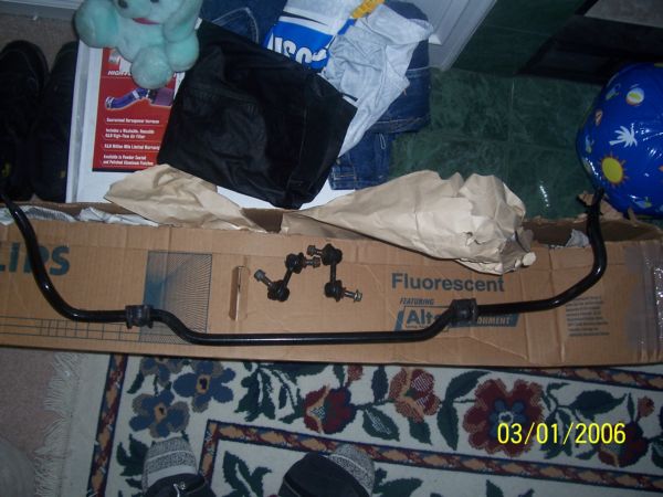

and the last pic is me excited hehe. and finally also pics of the rear sway. they will both go on the ride hopefully next thursday or friday.

damn those look so cheap compared to progressive rate H&R lowering springs...good springs none the less tho...

i can't see how people buy used springs

Why would you need the endlinks for the RSX rear sway bar?
it got'em for free , plus, rsx endlinks are better than stock endlinks
Majin, you'll feel huge difference in handling after you install both springs/rear swaybar. But, do you have the shocks to go along with???
whats soo bad about buying used springs
yea im excited as you can see hehe. im usin stock shocks/struts. and im not crazy, im just carefull. they will be fine. and if/when they blow it will be because of my carelessness, and i will grab up some new ones when needed.

on/t, springs look nice and you definitely will feel a difference in handling with the sway bar. Just be careful on those stock shocks, go slow over speed bumps and watch out for dips in the road, though they still will blow eventually, you can get some more life out of them.
plus, rsx endlinks are better than stock endlinks...
It's the same part and part # from both Honda and Acura....there is no difference between the two......
if there is no difference, then why do the civic endlinks break with a rsx rear sway sometimes?

lets hope you install the rear sway bar in the correct orientation.
please elaborate

there are lumps in the sway bar that "correspond" to the lower control arms/exhaust pipe. if you install the sway bar upside down, the sway bar will hit the lower control arm and rattle against the exhaust. it will also snap your endlinks.

thanx. ill make sure i don't do it upside down. i know it don't count but ill rep ya. you saved me a big headache cause it don't say that in any of the DIYs or give good picks of endlink installs. thanx again!
