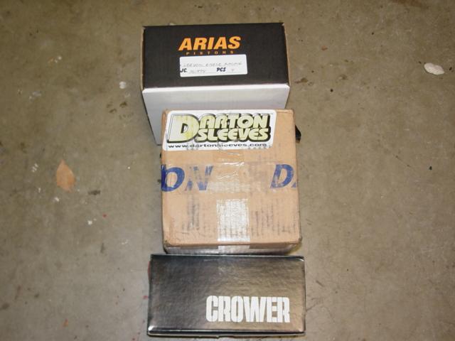

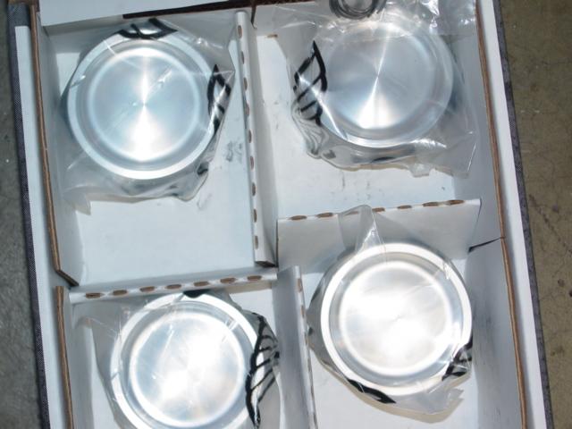

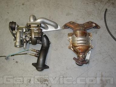

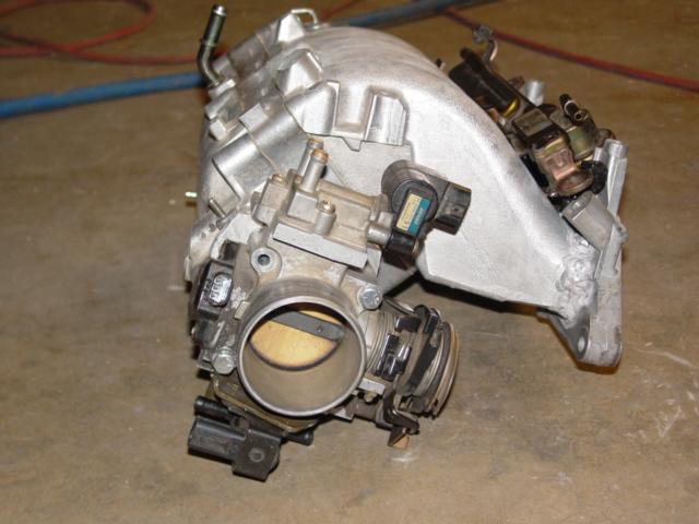

I thought i would make a thread that was dedicated to the evolution of my car. And just for kicks, i added pics of my old CRX also.
I built all the turbo kits on my cars. And damn, looking back, my stuff just kept getting nicer and nicer as i did it more and more.
So heres a look at the evolution of my car, from earliest to newest.
so enjoy!
I will upload more pics later as i finish more parts. But more or less, this is where i am in progress.

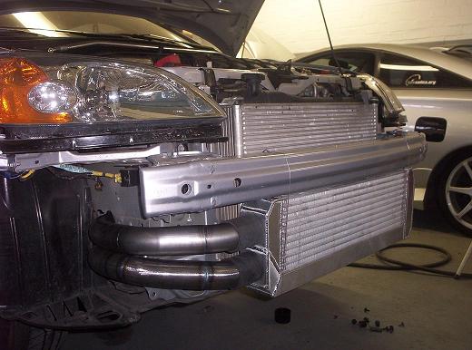

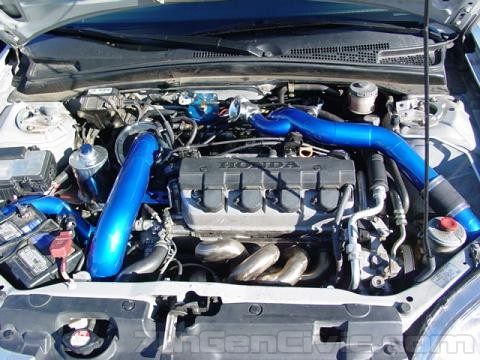

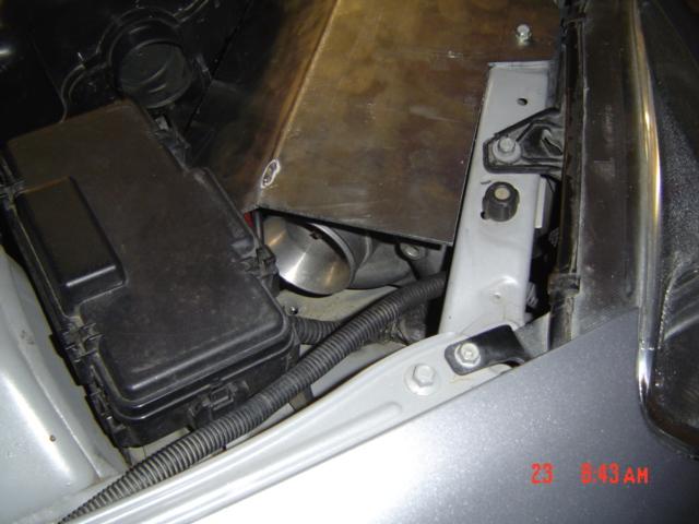

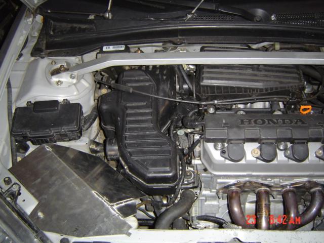

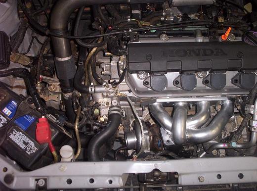

so what do you guys think of the placement of my turbo?
It isnt a small turbo either. It is a turbonetics T3/60-1 hybrid with a stage 3 exhaust turbine.
I put it there to try to make it more of a sleeper. I painted that aluminum heat shield black. And all the intercooler piping runs underneath the stock plastic air box into my GSR intake manifold. I am even going to top off the look by buying and installing a car bra. its going to look like some old ladys car, but have 400 whp.

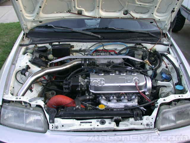

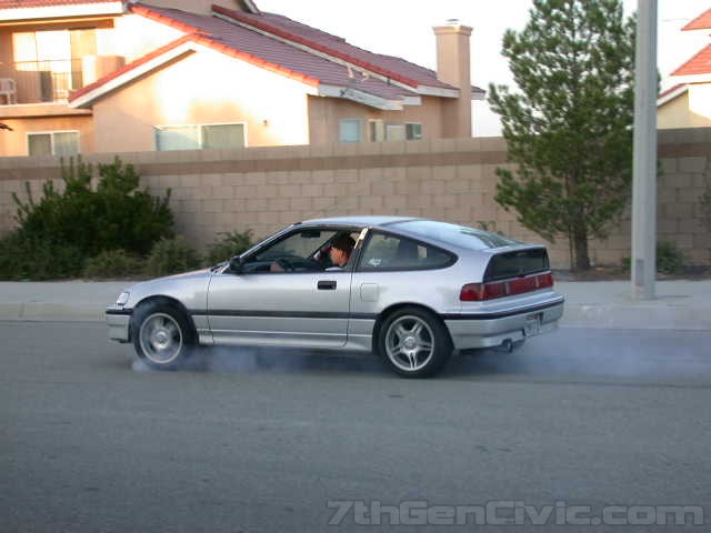

My crx was an HF with a SOHC ZC in it. I still had the POS tall *** geared HF tranny in it. I went 14.4 @ 100 mph on 15 psi. And i never shifted out of 2nd gear. Thats how tall the gears were on the tranny. I made 217 whp on 10 psi. Never dynod it on 15. But it ran good. I ran 15 psi daily. I still wonder how fast it would have been if i swapped the tranny out to the Si tranny. I see crx's going 13.2 with the same amount of power that i had.

no. actually, it was all bone stock. Only mods other than the turbo were my rims/tires, and an ACT 6-puck clutch, xtreme pressure plate, and lightened flywheel.
