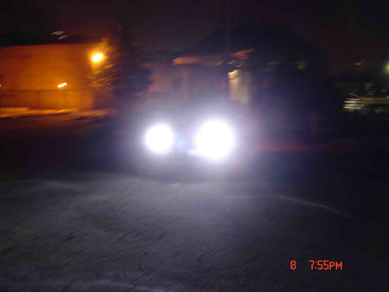

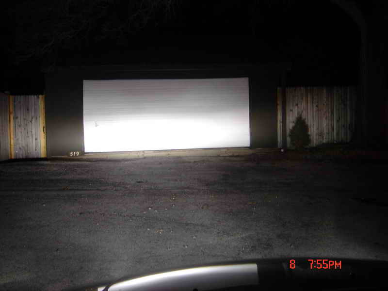

While I was taking the pictures, I feel like it's kind of bright?? maybe i have been driving with the stock for awhile...
Please let me know if they are too bright or not. are they aiming too high? I was just driving 5 mins ago and at the intersection, there's an old lady going to make a left turn and covering her eyes while she's turning, i wondered if my HID is too bright??
(if you think the light is too blue, it's probably because i don't know how to take the picture.. the light is actually purplish + whitish...)

its not that bright...4500k is brighter than that but its still brighter than anything u'll usually see on the road

dude holy ****. you have massive glare.

I think it's too high.
Your cut off line should be about half way up the little tree on the side.
That's what I'd estimate it as.

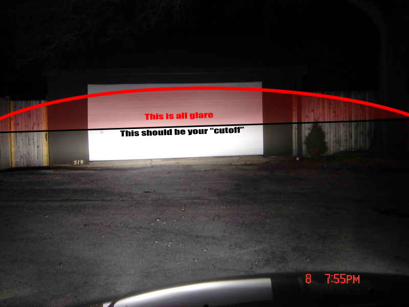

are you on leveled ground? or does it go uphill?
if its leveled, drive your car up to the wall/garage put some marks where your headlights hit, then go straight back 25ft, and see if the beam goes above or below the marks.
If it goes above, then you need to aim the headlights down,
If it goes down, then you are fine

i just tested it.. it goes down when I move away from the wall so i think it's fine
but it has a lot of glare.. how do i fix it? or there's no way to fix it since i'm using the oem housing?
