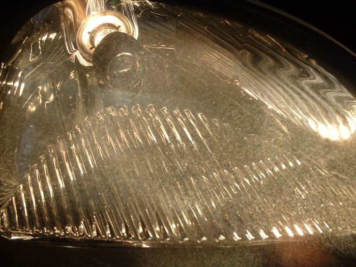

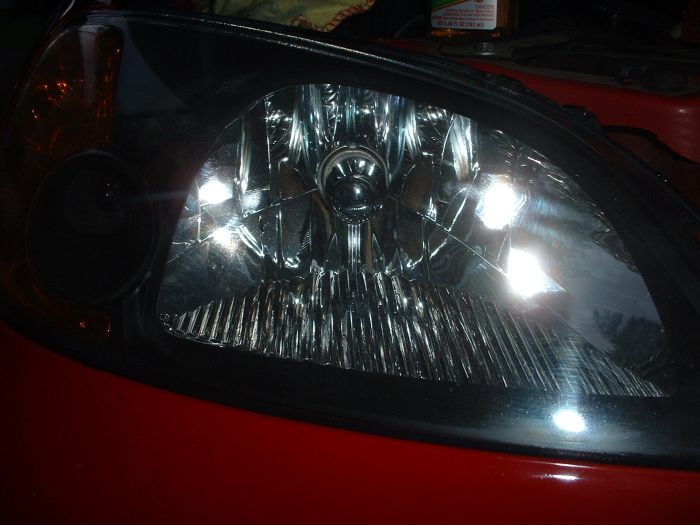

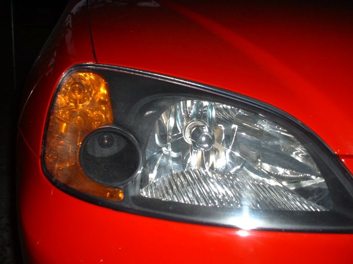

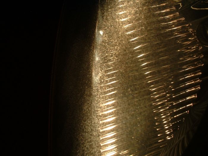

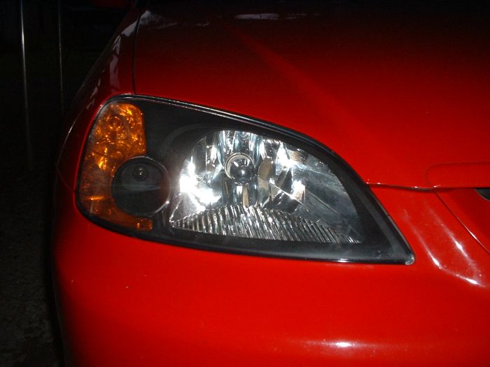

i might have got some humidity in my headlight. what do i do to get it out? you really cant tell in the day but in the night it tends to show. what caused it and what do i do? thanks!
Edit here are some better pics as you can see lights off no water look, lights on and standing at an angle you see it. i wiped the inside on the lens and nothing changed sooo.........???????????????????????

when you opened up your headlights and sealed them back it prolly wasn't sealed "properly" that's what causes the condensation in your headlights when air gets in there and stuff.
Solution: Open them back up and reseal them or just let it be...happens to most people but it's really no biggie unless you got water building up in there haha.

They didn't get reaseled properly. Take them back apart, get the water out, and reheat the sealant. You might also want to run a silicone bead around them. IBTM

you didnt seal them well when you took them apart, so water gets in there from the rain or just humidity. you can vent them out by taking off that black rubber thing that goes over your lightbulb, but if you want to condensation to stop youll have to reseal the headlights.
use the caulk that plumbers use for bathtubs etc., just use the clear one.

im not sure it is humidity because i stuck a peice of wire with a rag on the end in the headlight wiped what i could and it still look the same. it could just be pitted.
