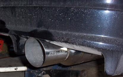

ok exhaust is touching the bumper will it melt it or what and what can i do to fix it if so =\

change that rubbur hanger......

can i streach the hanger it came with or do i have to buy a new one and if so where can i get it at.. and btw go to the exhause clip page its the greddy evo 2

somehow it can be lowered...either new hangers or heating things up but you can get it off your bumper though.

just start pulling down on it in an up and down motion. that will bend the hangers so it doesnt rub against the lip. that what i did on mine and it worked fine.
