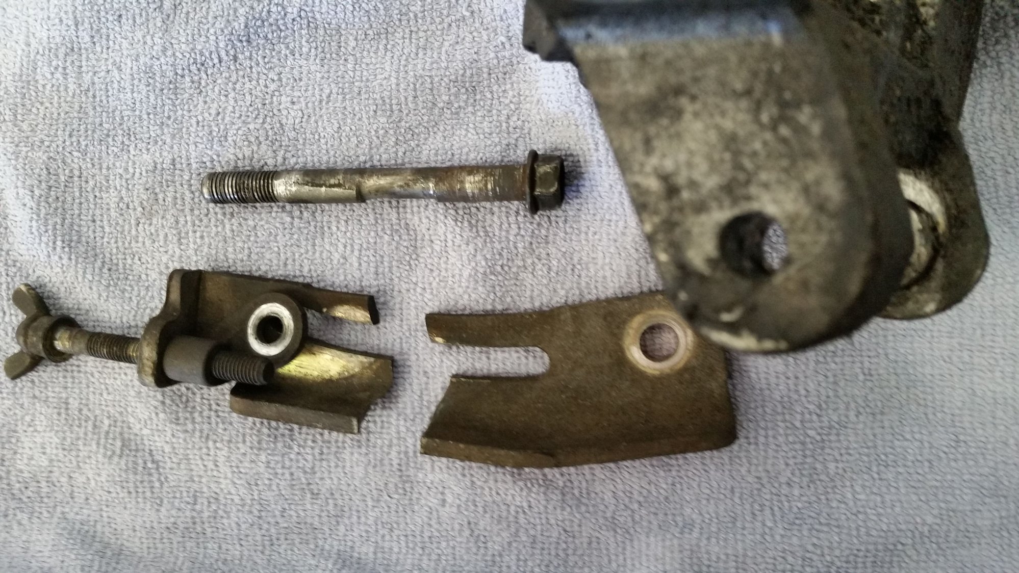

Re: Changed ECU - Still in Limp mode
This is from the last one in our shop....an indy shop did the timing belt and left the alternator bolts loose and caused not only the damages in the picture, it also ruined the PCM.
