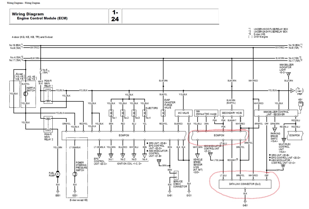

Plugged OBD II to pull codes. Wouldn't connect. Had power but wouldn't connect. Time to fix it.

SO, I have the car back in the garage. Have to find out why, with a replaced ECM, is the DLC not establishing a link. The DLC has power. The code reader turns on. But it just won't establish a link. The mechanic at the dealership thinks its a broken wire somewhere between the DLC and ECU. The problem is that the wire harness runs behind the blower. That means that just about the entire dash has to come out to get to it. HELL NO.
Going to start testing with a multimeter using this
Spoiler
I have a "copy" of the 2004 factory service manual but it's broken into a few PDFs and some have like 2000+ pages. Anyone know what kind of voltage and resistance I should be looking for each pin/wire?
Also, I had a hard time finding the DLC connector diagram to know what each pin goes to.
Any Ideas?

I think I found a start. Have to check the continuity between DLC ground and body (pin 7). If there isn't then I have to check between DLC #7 and ECM/PCM connector 3 #23. If no continuity, then there is a break.
However, if I there is continuity when I disconnect ECM/PCM connector 3 and test DLC #7, then there is a break in the ECM/PCM wire (even worse).

re: Broke Alternator adj bolt - DLC won't read codes (fixed)
You unplug the PCM and check continuity of the (3?) wires between PCM and DLC.
Follow the wire COLORS at the DLC. And note carefully, something like "red/wht" is NOT the same as "wht/red"
BACKPROBE so you don't ruin any of the tiny terminals inside the connectors at DLC or PCM
If the wiring is not open circuit then your used ECM is probably also junk. Just like your original PCM.
I checked ground (black wire) at the DLC. It's good. I checked white/red, not red/white, and got 11.95v. It's good. I then checked blue white (#7) at the DLC. No continuity. Next step is to check the wire (LT BL) between DLC (#7) and ECM(E23) for continuity. If there isn't any, then I have an open on that wire and need to repair. If there is, then it's the ECM.
That's what I'm afraid of. There was an issue with the dealership. I have a 2004 civic. Honda decided to update the ECM, so the P/N doesn't match what the Honda system uses. It's an old P/N. So what's the catch? The new computer is $780. Ebay has them at $300-500. If the test proves its the ECM, then I need to find a pick n pull and grab me a computer and see if that works (granted they are a PITA to do).
Assumption: Everything probably was fine and working until your alternator broke free, and that failure can't cut or ruin wires in the dash.
The only "what if" scenario I can think of is the that on that exact trip home, I managed to run over a plastic water bottle that magically slammed into my car so hard that I could feel it in the shifter (5 SP). Not to mention that all my ground wires had only 3-6 strands of copper left to them so they had horrible grounds. But what could an empty water bottle do to my car that would cause any issue like that? Hell, it probably caught in the belt, pulled and snapped the bolt, and did all this. Not to mention many people don't understand that you don't tighten from the bolt that snapped but the one on top. The bolt that snapped is just a holder for the bracket that does all the tensioning.
If you can find someone with an identical car you could plug your PCM in and see if it will communicate with a scanner while plugged in a good car.
I'm trying.

Well, worst case scenario. Before I posted this, I went backwards on the troubleshooting tree. Tear everything apart, check the last thing first and go from there.
I have seats, center console, the entire lower dash, and panels removed. I just finished checking continuity between DLC and ECM E23......coninuity is good. AKA I got screwed on an Ebay order. Send it back? The seller is in TX, in the path of where the hurricane hit. SOOOOO, I'll have to wait till it clears to see if he can take it back and post office resumes operations.
Time to put everything back together and find a junk yard near by to pull a computer from.

DLC terminals 4 and 5 are always grounds.
16 is always battery power. (OBD2 numbering, not Hondas numbering)
The rest of the wire positions are up to the manufacturers. Colors should be consistent though according to the diagram you posted..
