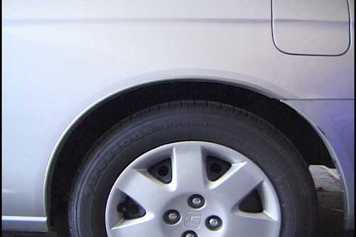

here is my coupe stock with all audio stuff i have in it now, notice the nose bleed gap..

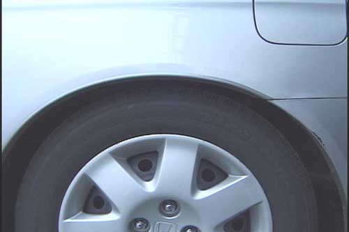

and here it is with coupe springs, the gap is closed nicely...
those are with goldies right? and how long have you had them?
i'm asking basically to find out whether or not they have settled in yet..
thnx
Old Apr 24, 2003
EnProceso's Avatar
Posts: 10,823
From: Bay Area, CA
Rep Power: 402
yeah they are goldlines, i've had them on for nearly 3 months, that pic was taken around after 2 months so they have settled all they were gonna settle.
