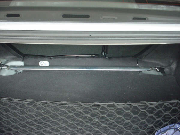

does dc even make rear upper strut bars for 7thgen?
pic below.
its just generic one off ebay

heres pic

I have an OBX one (which is considered generic). I don't know if anyone really makes one for our cars, DC sports definitely doesn't. I think neuspeed might but I am not sure. You will have to get an RSX one and possibly modify it. Ask Grey about rear strut bars. I think mine is fine.
If you get the 22mm progress bar, that comes with an integrated tie bar. If you get the 22mm RSX-R bar then you will need the DC rear lower tie bar. You do not NEED a rear upper strut bar if you get a lower sway and tie bar. There have been some problems with the 22mm sway bars tho.
