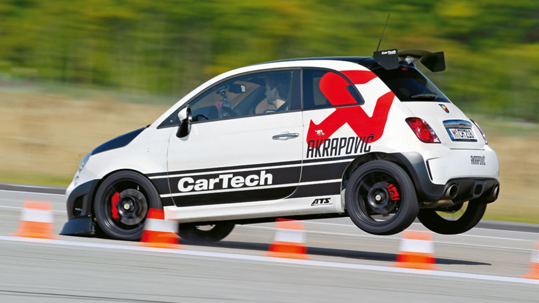

is this what you refer to as dipping?
is it this extreme during braking?
HAHAHA no, but it does feel like that sometimes. I definitely don't have any reasons to ever want to attempt getting air haha
