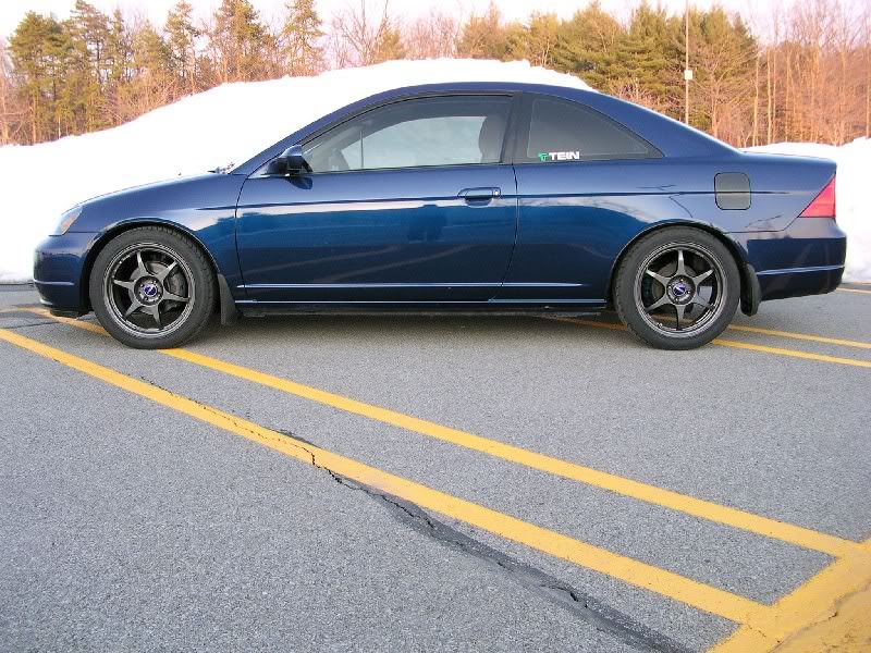

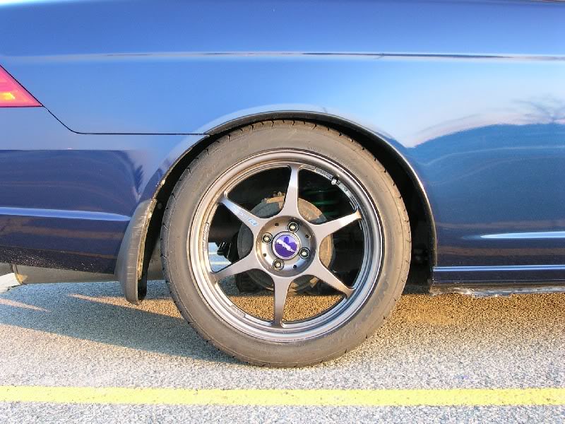

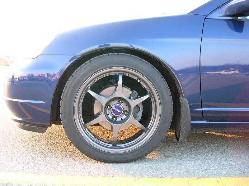

edit: to give you an idea of what the tokico blues/s-tech combo looks like installed, here you go. Found some pics I snapped back in 2004. lol
The rear is a bit lower than it should be because back then I had a heavy *** sub box in the trunk. Thing prolly weighed about 100 pounds.
