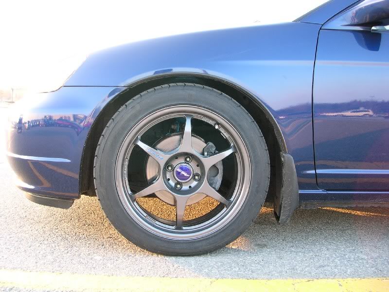

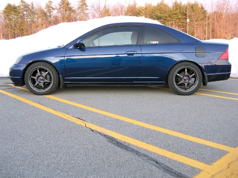

If you only wanna drop an inch, go with springs/struts. Tokico HP struts and Tein h-tech springs (will drop 0.7"/0.8" F/R) or Tein S-tech springs (will drop 1.3"/1.4" F/R) have always been a good do-to setup.
If you wanna see what that drop will look like, here's what my car looked like with Tokico HP struts and Tein S-tech springs. Rim/tire combo is 17x7 wrapped in 215/45-17 tires
Closeup of front wheel gap

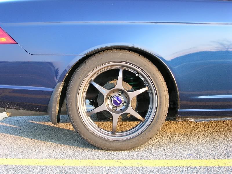

Closeup of rear wheel gap (keep in mind, I had a 50-60lb sub box in the trunk at the time)
