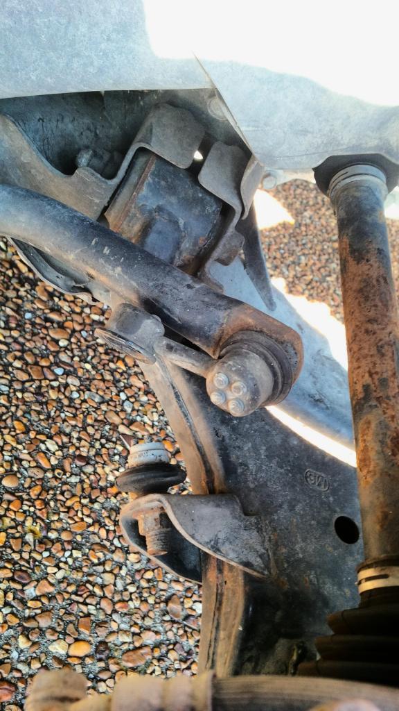

Hello guys, i m new here and i need some help/advise from you.
With the wheels on the ground i noticed that both (front) have a gap. (easy with the hand i can turn them) is that ok? or should be fixed? are not bent or broken.
Thanks.

I'm not clear on this yet.
Pics?

I m talking about this

I kinda meant the gap part you mentioned. That's what I couldn't picture in my head.
What I see in your pic looks normal to me.
Yes they are supposed to be able to pivot a bit, both ends of each link are comprised of a ball-and-socket type joint with a threaded stud sticking out.

like i said, are not bent or broken. only that gap worried me, very easy to move it when the wheels are on the ground.

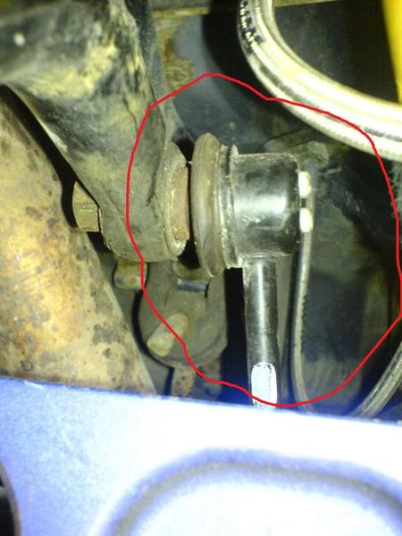

this is a broken piece (mine). yours is just as they should be.

i thought they should be solid and with no movement (because of the 4 rivets on the side). But from what i understand needs to be replaced only if are broken?

They can become noisy as wear develops between the ball stud and nylon liner. You would be able to feel it as a small amount of free play when you grab the ends of the sway bar and push/pull up and down.
The 4 dots you see are what secures the nylon liner into the cup area.

they should move or your suspension will not move.
