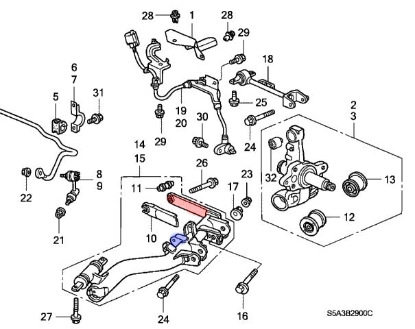

Best pic I could find at the moment.
The bushings you have been talking about for one side are parts #12 and 13.
The toe adjuster is made up of bolt #16 (with eccentric washer) and eccentric washer #17, plus a nut #23.
The bolt #16 goes through a pair of ears welded to the lower control arm, and goes through bushing #13.
The bolt #16 is stuck inside the steel center sleeve of bushing #13. That sleeve is bonded to the rubber of the bushing. If it is forced too far it will tear the rubber in the bushing.

Anyway, now that I know what's what for the most part, I do have a couple small followup questions, if you all will bear with me, so here's that diagram again, marked up for you:
Where in the diagram is the lower control arm? The part I highlighted in red?
And what is #10? An alternate variety of the part marked in red?
Where exactly does the sway bar linkage connect to the other parts? Is it the bracket I marked in blue? I mean, if he's going to be taking apart this whole section anyway...shouldn't I just have him do it at the same time? Or is this a false assumption that it will save me money in the end? I don't have the finances to do too much work at once.

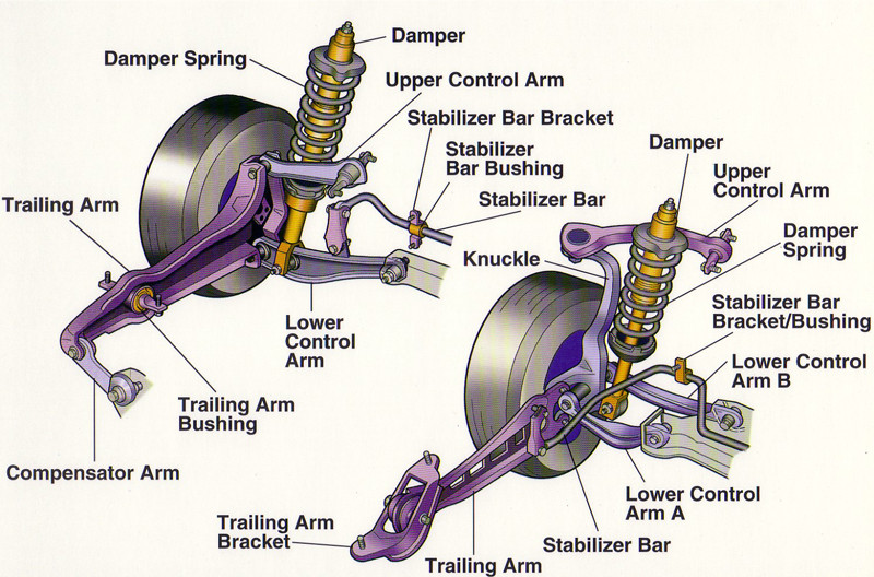

Finally, referring to the first diagram I posted up above, why does the 7th Gen Civic have the style of suspension on the right? It seems...cheap, or cheesy, and unnecessarily complex. Is it just cost that determined this design? The one on the left seems so sturdy and neat and simple.

Ah, thank you guys so much for finally explaining everything to me! I was very confused by the estimate that did not indicate that the knuckle bushing replacement was actually the repair for the toe bolt and that my mechanic was estimating worse case scenario for doing both sides at the same time by removing the knuckle and using an actual press to get the outer collars of the bushings out of the knuckles.
By post 12 I finally figured out why, I probably did a lousy job of explaining though. I'm overly technical, I tend to forget others may not be.
In the end, I came to believe that my car had suspension like the diagram on the left, but in reality, I now see that it has rear suspension like the diagram on the right of this picture:
Neither of those really match your car.
I still haven't found a good diagram of the car though.
This might work (with the exception of coil spring placement--this is for a much newer car)
I kinda feel stupid, but I know I'm not stupid, nor is it because I'm a woman; I'm just not a mechanic (well, maybe previous mechanics not using BIIIG WOOORDS like "tear the bushing," or lower control arm or rear trailing arm or knuckle is partly to blame.)
The lower control arm is made up of all the parts within the outline (box) numbered 14/15 (the two numbers are for left or right side).....One would purchase it (#14 or 15) as a whole unit, although the individually numbered items within the outline can be purchased separately if needed.
Geometry-wise, the lower control arm sorta forms a large "L", or maybe more like 2 sides of a triangle.
2001 through current model Civics and CRV 02 and newer all use very similar rear suspension design.....
Found a pic of the whole right rear lower control arm along with other parts....
10 is a thin plastic cover, it attaches to and covers an area of the flat metal arm right behind it.
What you marked in blue is one half of the strut mount. The tab sticking up immediately above and to the right of the blue is the tab for the sway bar link to attach.
The reality of the job is the lower control arm and the sway bar link and the strut probably will not be removed from the car nor disassembled in any way.
The "knuckle", part #2/3, is what will be removed from the car (detached from the lower control arm and upper arm) and carried to the workbench. It contains 2 of the 4 bushings in question.
To keep it cheap, I'd suggest only replacing the parts that are causing trouble (the side that is stuck).
If the toe adjuster on the other arm is not frozen/stuck/seized right now, I'd suggest take out the adjuster bolt (#16) and grease it or apply anti-seize on the shaft to TRY to keep it from becoming a problem in the near future. (Do the same for the side getting replaced too.)
THEN do the alignment.
Just so you know, I see plenty of cars that have seized adjustments after only a couple years on the road. Yours is better than many...but there isn't a lot one can do to prevent things like this from happening.

I meant the whole knuckle concept vs the one boomerang-shaped rear trailing arm which is featured in video after video after video on Youtube. So it's like...more modular.
Yeah, the complete lack of one on the internet, that I could find anyway, is really weird considering how many Civics of this generation are out there. But ask about a 4th gen, and there are a thousand pictures and diagrams. BOOM!
I wish I could put it on a lift and have someone explain each part. It would take me all of 10 minutes to have just about everything figured out. Another shop did this for me with my old Accord, pointing out the multiple major repairs needed to pass inspection. Saved the guy a whooole lot of 'splaining, and it saved me from any more painful indecision about whether to try to save it or junk it. With my current mechanic, no customers are allowed on the shop floor, forget under a car on a lift.
Hey, and look what I just found! In the Google Images search on "EF Civic rear suspension..."
And this video... Rear suspension in a CRV, it's the same basic design as the Civic but you can see it move as the guy drives
