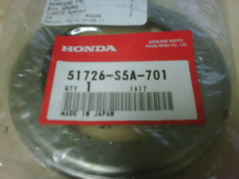

The mount comes by it self (With a bearing housing)you will need to buy the bearing separate as they sit in that metal housing in the mount.
This is the metal one
I think the plastic ones are 51726-S5A-004 and the metal ones are
51726-S5A-701 I THINK!
The mounts part # 51920-S5A-751
