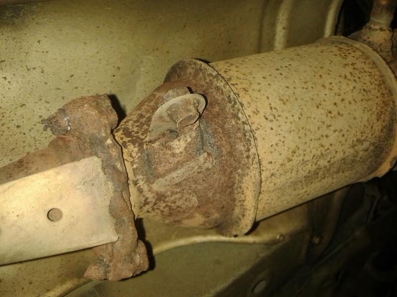

I was happy that the only thing I have to buy for my car is sway bar links and now my mechanic told me that I have to replace my CAT and guess what I found under my car??? A welded exhaust flange, where did the bolts go?... sometimes I hate my car -.-
