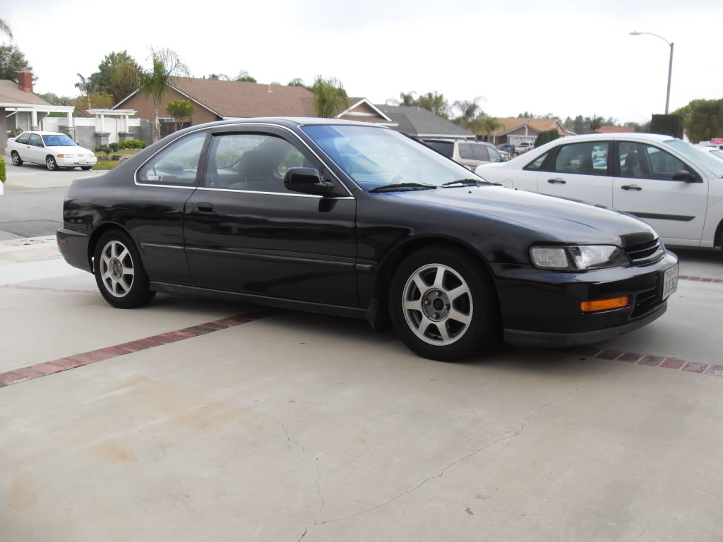

From first-hand experience (my older brother's Accord), it took at least 1 week for the springs to full settle. He waited 2 to get an alignment.
Day after install (Eibach Sportlines: 1.8in drop). We measured, and at that point, it had dropped the car about 1.2in.
And 2 weeks later. The full 1.8in drop. You can see the car is definitely lower.
Now, when both of us installed our coilovers, they only settle about .1-.2in. I'm guessing that was due to the coilovers having much stiffer springs, that the softer Eibach Sportlines. It makes sense that a softer spring will settle more than a stiffer one.
