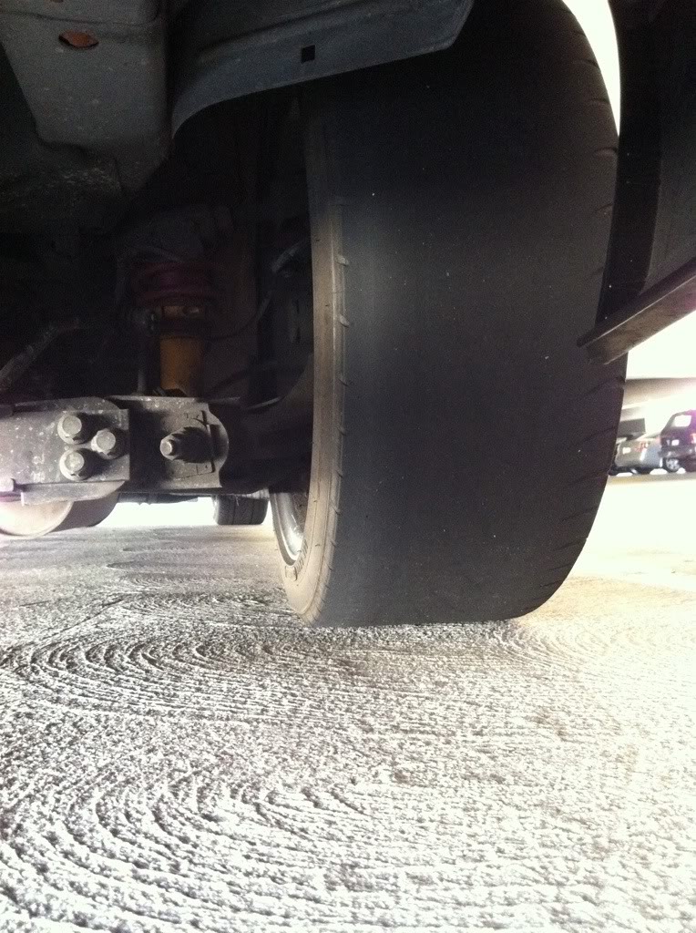

here is my tire that i ran to death just to see how my -3 degree camber wore my rear tire (when i ran -3 in the rear. i run -1 now because want to decrease my understeer, but thats a different topic).
as you can see it wore out pretty even
