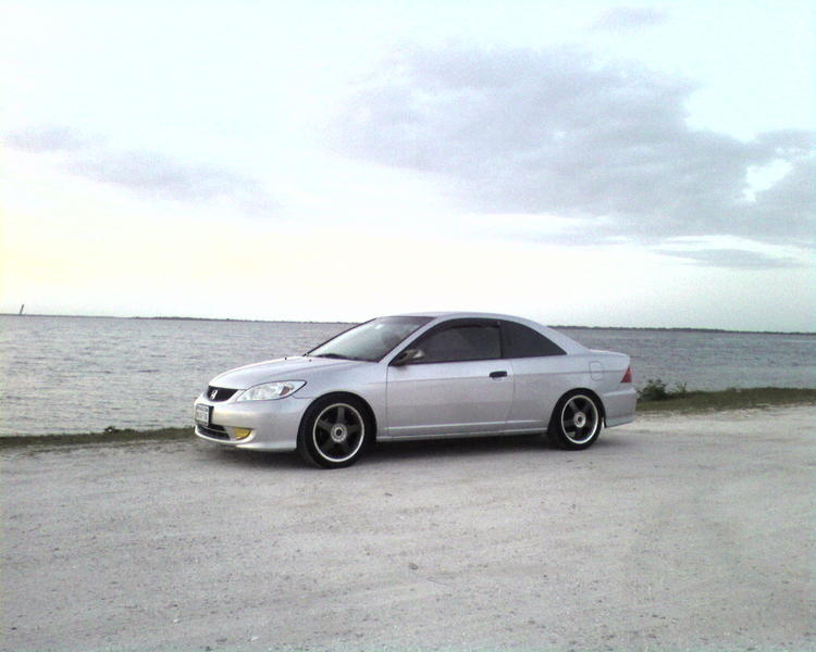

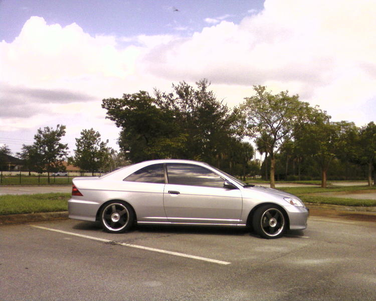

your making the same mistake again. you will be dropped but you wont be able to adjust it to your liking.
if you buy springs, you will ALWAYS have a bigger gap in the front than you do in the rear (a lil less with the neuspeed)
example:
you'll see that and have OCD and regret not having coilovers where you can adjust every milimeter of a drop

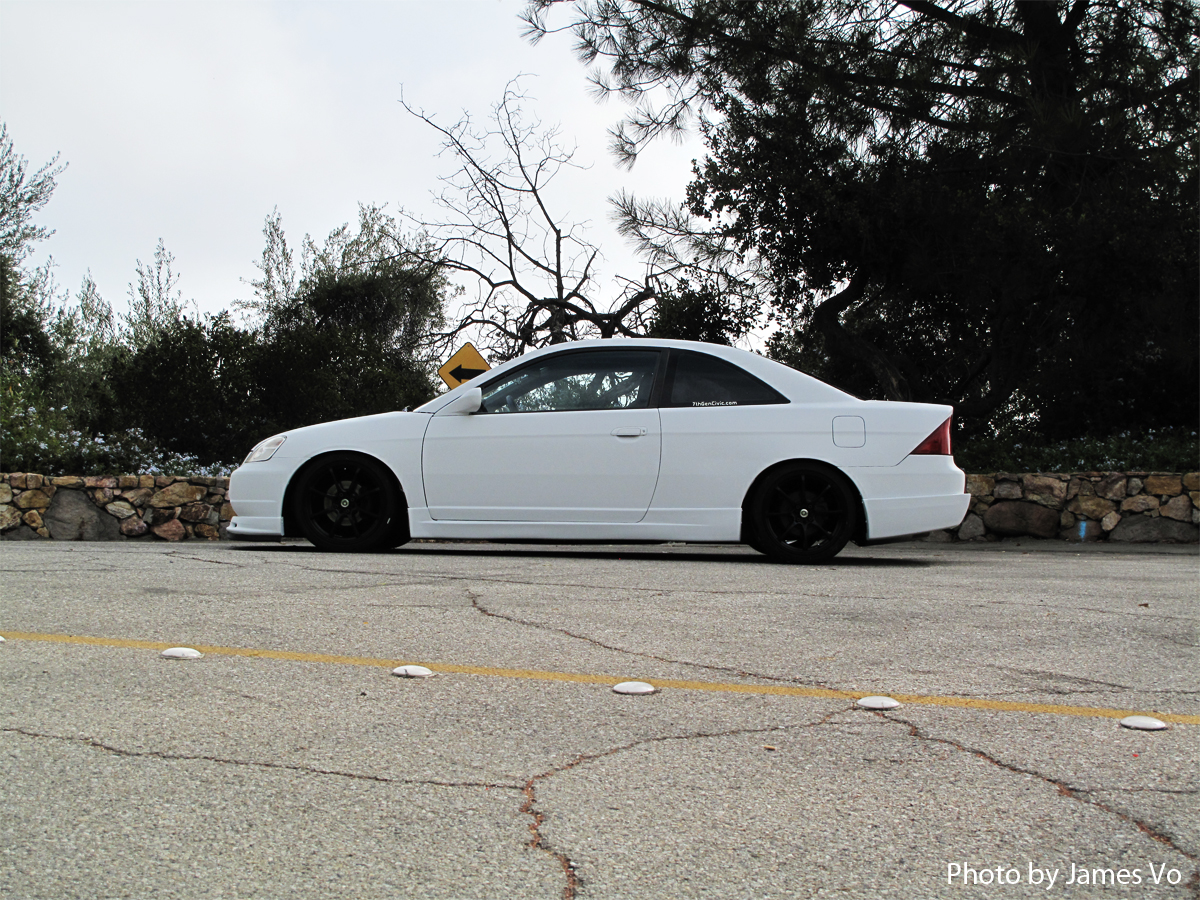

like this:

in case you didnt think i was serious about the 4+ inches

heres a better shot of the even drop
