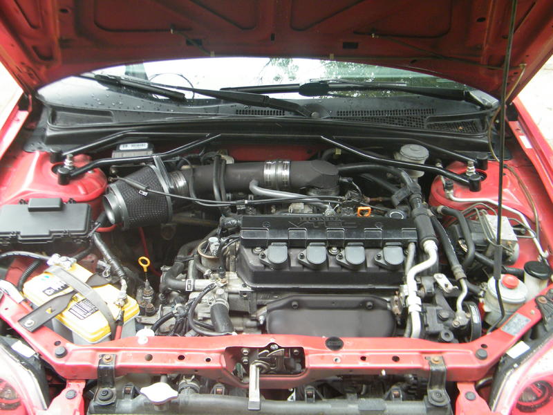

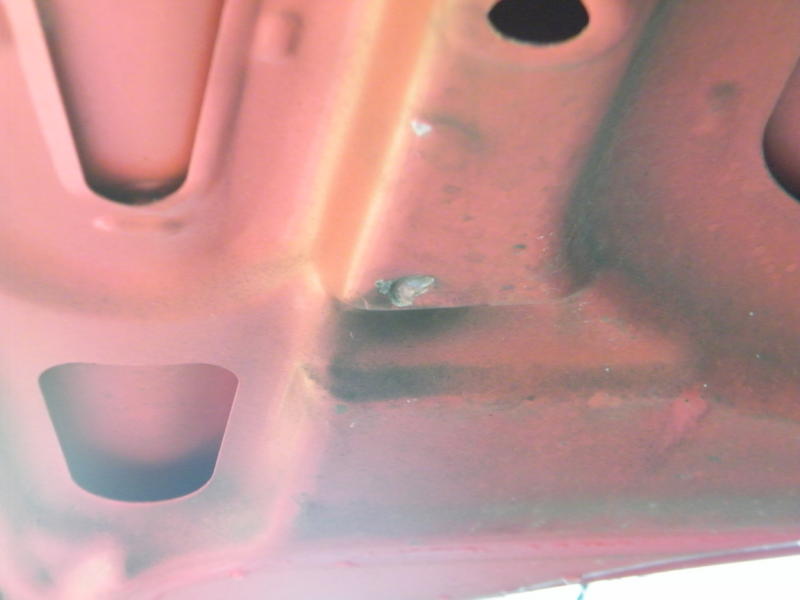

Hey everyone,
I've been hanging around here for a while...not really posting...but taking advice from everyone on their cars. Now I have an issue that I really need help with. In the last 6 months I have replaced my struts with tokico d-spec struts on all 4 corners along with eibach pro-kit springs. Since that time there has been an unexplained rattling coming from my passenger side strut area. I have been looking and looking and haven't been able to figure out what it is. Well it was staring me right in the freaking face. The strut is actually hitting my hood!! In the pics below, there is a huge indentation where the strut has been slamming into my hood. I was wondering if anyone who has d-specs has had this issue?? Can anyone recommend how i should take care of this? Is this a strut issue or should I be ok just cutting a hole in the support bar? Also, the passenger side strut is leaning in to the right. THe mount is brand new and this has just been slowly getting worse. If anyone wants to shoot some ideas my way...it would be much appreciated. Thanks everyone.

If it's only the one side I'd say you probably got a bad strut out of the package.

well...unfortunately it is hitting on both sides, however the driver side is less severe than the passenger side. The driver side strut is not leaning, however. This is really frustrating and I feel slightly stupid for not figuring this out sooner. What are the odds that both struts are bad? The ride feels normal to me. They don't seem blown at all or anything like that. Could the control arm be bent causing the lean? That still doesn't explain the hood banging though.

Drill a large clearance hole at the point of contact in your hood so the top of the strut just passes through. That is, as long as you don't mind this sort of DIY that requires a bit of hacking away. I'd give you the green light, seeing as there is a hefty flange there to cut away and there's already plenty of stock holes in there for other reasons. As long as you're careful and clean, that should at least help you forget about the annoying problem for good. I'd also put some thick foam pads under the hood just in case, that way if your struts are still hitting, they won't put dents in your hood.
Just make sure you didn't get defective struts in case something might be wrong with the way they were manufactured.

I was gonna go with the whole cutting a hole in the hood bracing....but that still won 't fix the issue of the leaning strut tower...unless it was this obstruction that caused the leaning to begin with?? I think the leaning is the bigger issue now as the other is an easy fix. I guess I could disassemble my suspension and figure out whats wrong
The issue I'm having with the leaning strut seems really bizarre. I'd be interested to know if anyone on this sit =e has ever had a similar issue. Seem's pretty rare to me though.

ive never seen that before only time i see that much lean is when someone uses an adjustable camber plate and is on purpose.

Well....Seeing as how I own the car and to my knowledge no one has installed camber plates behind my back in the last 2 months, this was definitely not on purpose! lol

Alright Guys. The issue is getting a little worse. The strut is leaning pretty hard core to the inside and I'm really worried something is bent. Could the strut mount be bad??
Any other thoughts would be really really helpful.
