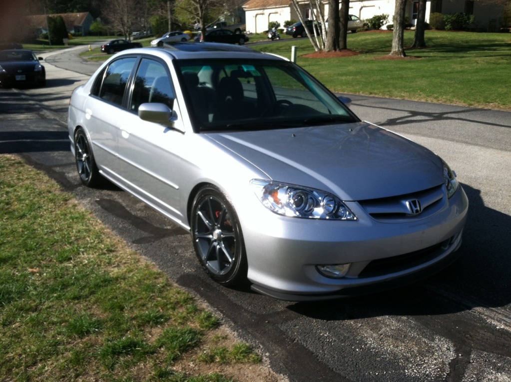

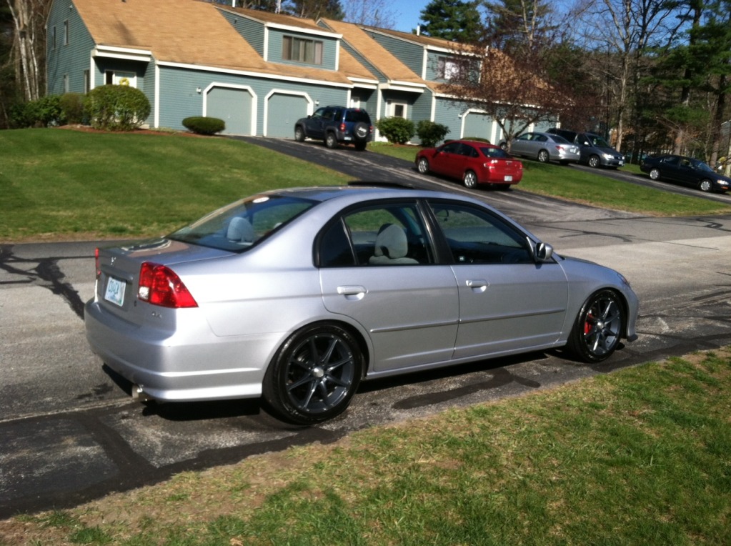

I am riding 215/45/17 on my 04 and have a ZERO finger gap and only rub in the front on decent bumps (infrequent though I do cringe even though its the splash guard which i refuse to remove)
I did however have to roll the rear fenders. I did not have a fender roller so I used a heat gun and a small rubber mallet. Worked fantastic! they are rolled and look great! NO RUB! I did rub like a motha before they were rolled on bumps and corners. I also had some flaking and rust underneath so I got a bottle of touch up paint did some sanding and made them look like new and prevent them from rusting.
Depending on the stiffness that you set you may be able to go to a 1 finger gap with no rub however I would suggest rolling the rear with a 215 tire and they will no doubt rub if you hit a decent size bump. up to you!

Thanks TFMEX, I love the stance of your car! I probably won't have to roll any fenders with the height I'm going to achieve. Also my coilovers don't have adjustable stiffness, so the taller the better in terms of longevity.

Thanks. Took me a few weeks of adjusting the preload to get the right feel I wanted. I'm dropped with Skunk2 Pro S II's. I know most wont have nice things to say about them but they ride GREAT and are very easy to adjust. I dont have the adjustable dampers either. Does your pre-load get adjusted independent of the ride height?
My only gripe is that the back cant get any lower without removing a spanner nut which isnt a big deal but with the 215 tires it rubs on the inside of the fender wall (not the fender itself). I do have about 1.5+ " of adjustment in the front tho. which would nearly put me on the ground (22").
