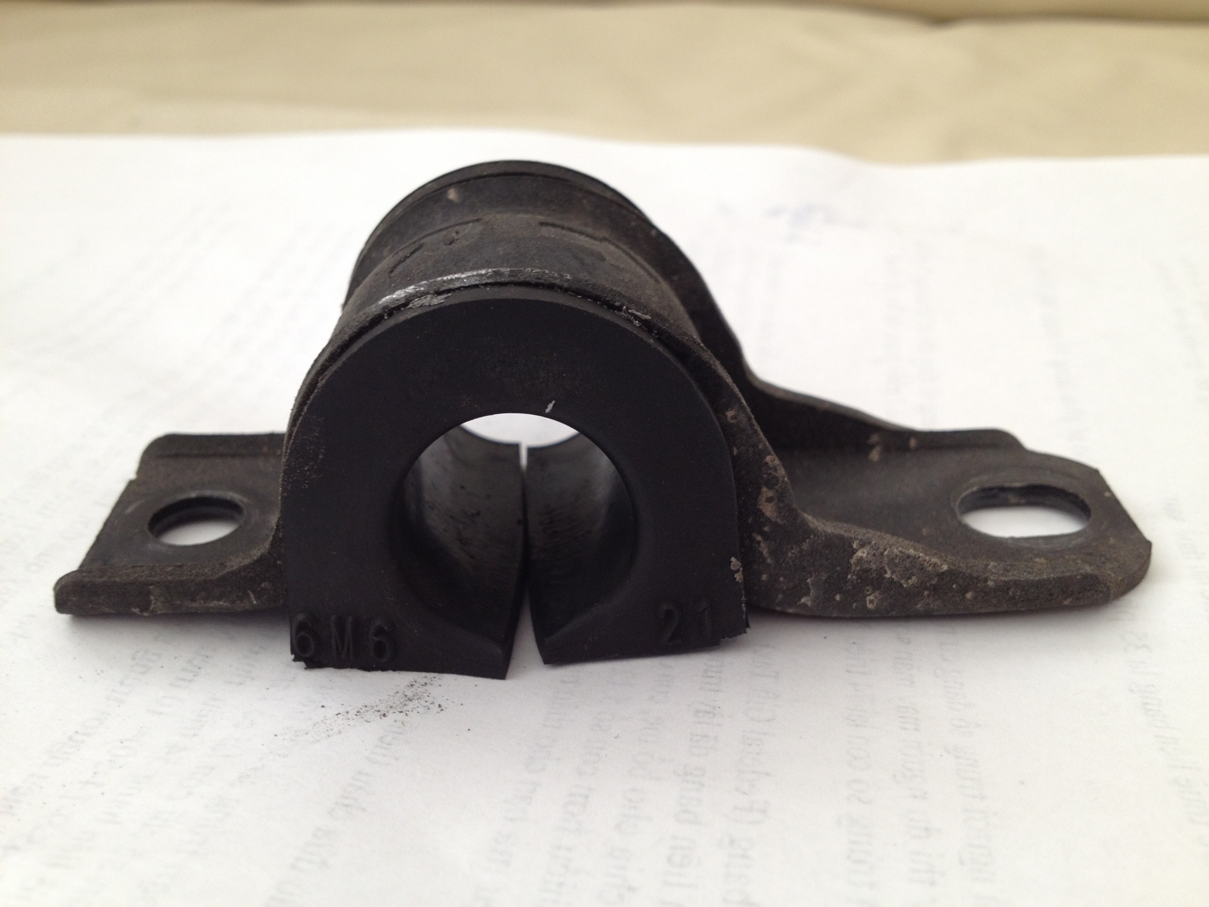

^Yeah i figured the same thing.....so how does that work? Bigger bushing, bigger bar, same size bracket..?? Maybe the 19 and 22mm bushings are thinner? Thoroughly confused here
Old Aug 7, 2012
Brooks952's Avatar
03 Civic EX
Joined: May 2012
Posts: 32
From: MN
Brooks952 is an unknown quantity at this point
Re: Rear sway bar bushings
If you get stock 21mm rsx sway bar bushings, they will fit in our oem "civic" bushing-bracket
Wondering where you got your bushings riceboi? The link at the beginning of the thread is for 19mm and checking that site I didn't find a 21mm. Just wondering which would be best for the 21mm?
Old Aug 7, 2012
sl33pyriceboi's Avatar
Posts: 9,196
From: SoCal 714/909/626
Rep Power: 353

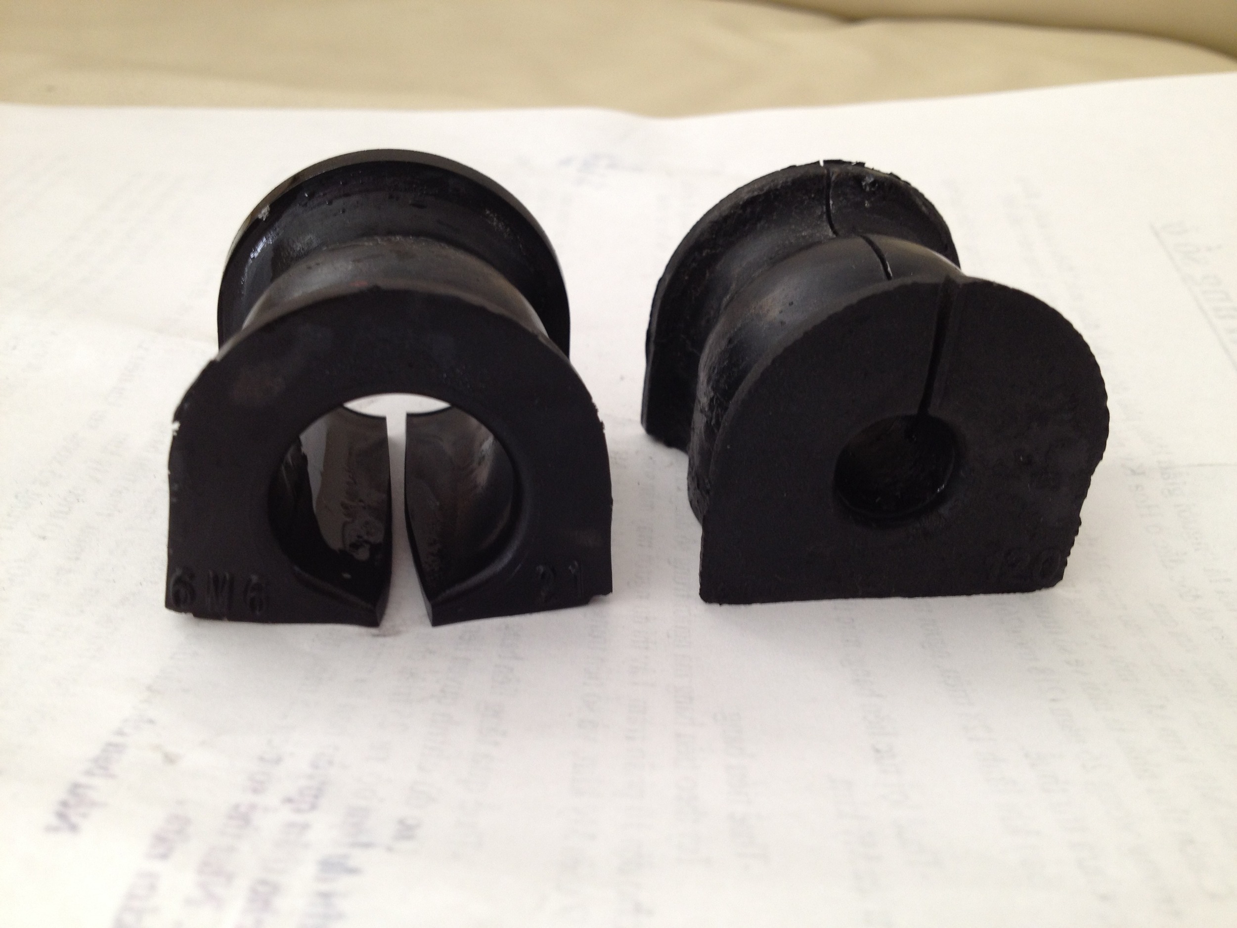

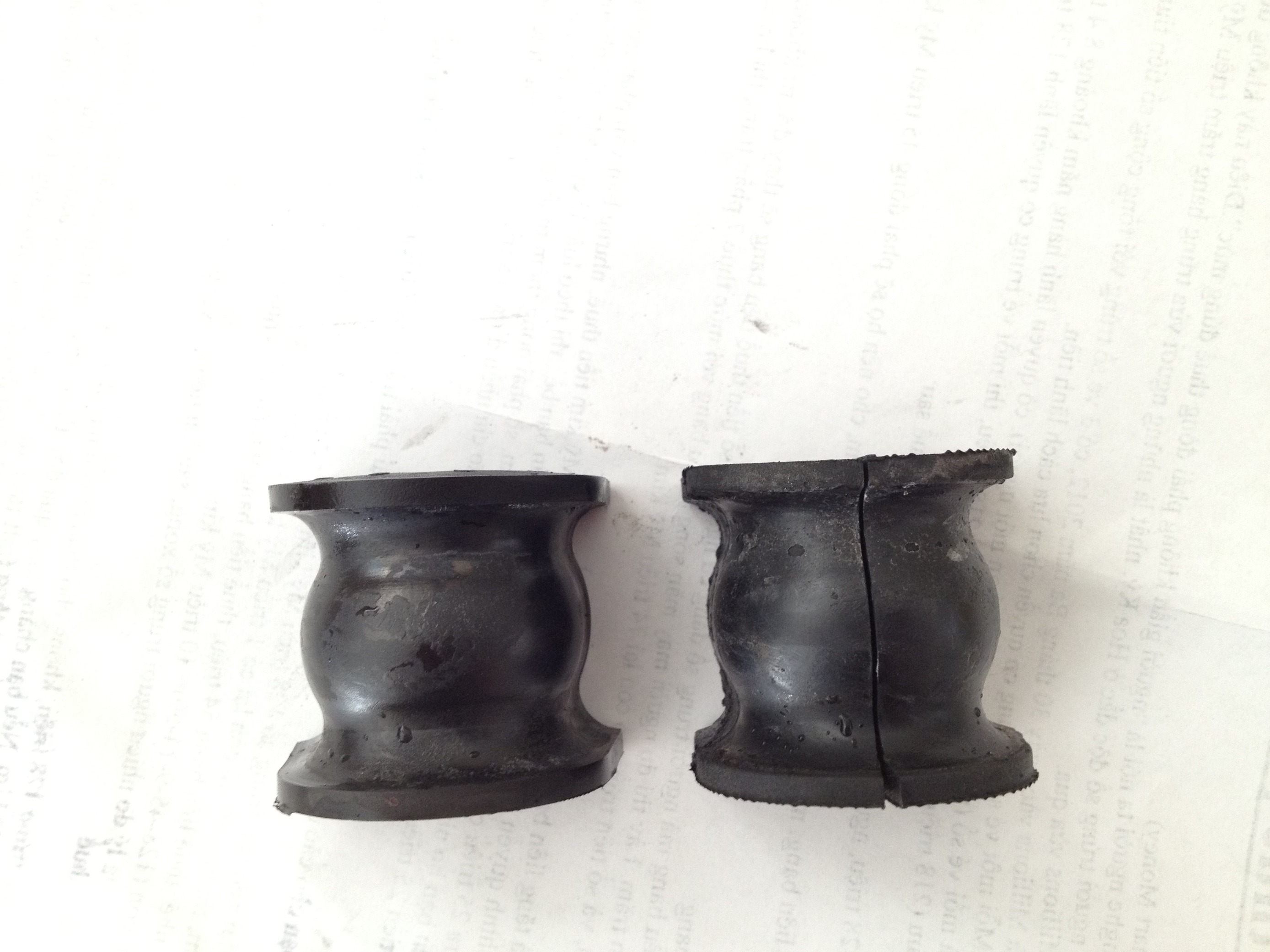

Stock civic bracket with 21mm bushing
