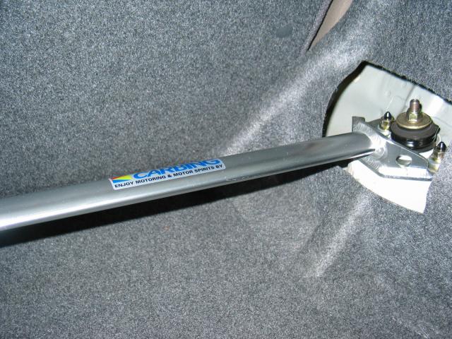

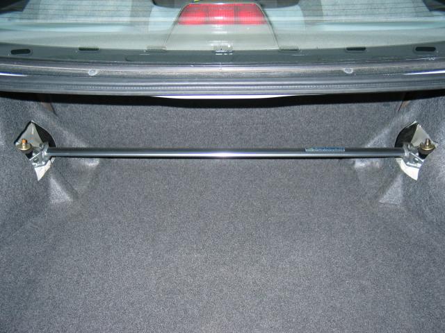

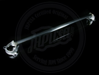

I believe SDAIDOJI has a good thread on this topic. If I'm not mistaken, Carbing and Mugen offer a quality one piece rear upper bar. I've got a multi-piece Cusco installed. J's Racing makes a sweet multi-piece bar too. To be truthful, rears are more eye candy, than functional, due to the close proximity to the trunk frame brace.
Carbing

Mugen

Quality for these two are UNMATCHED, but you will pay for it. If money is an issue, go the Type R route.

Incorrect, oem and replica DC5-R rear tower bars are a one peice design. There's someone on clubrsx that offers aluminum or steel ones that he makes for under $40 for either material.
You want the best front tower bar, well they're basically cosmetic so the $500 titanium comptech bar is nice when you pop the hood. Regardless of whether you buy that one or a used neuspeed one for $50 the difference in actual lap times will be in the hundreths of seconds, just don't buy a pos flimsy one off ebay and you'll be fine.
If you want pure performance then spend your money on dampers, springs and sway bars.

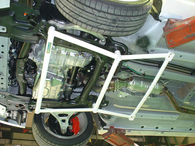

I would get a front underbrace before I would get the rear upper. There is a lot more slop in the front that can be tidied up (BIG opening for the engine and tranny - means FLEX). You've taken care of the upper, but you've neglected the bottom.
Carbing, Neuspeed and Tanabe are three off the top of my head. I've had the Neuspeed X and currently run the Tanabe Sustec. I was going to try out the Carbing, but didn't like the fact that it was made of steel (like the Neuspeed) - on top of the fact that it is painted white (Road Grime and Rust stand out more).
Being lowered, all the underbraces scrape, but at least the Sustec won't rust. Youl'll feel less steering and rebound slop, for sure.

The front end needs the most bracing. You're dealing with a box/cube with (basically) an open top and bottom. Most of the weight is here. Compound that with suspension movement, steering, braking forces, engine torque, transmission forces, etc, ad nauseum...
There is enough flex in the engine compartment that those of us with moonroofs should find a telltale dent in the roof panel when lowered and unbraced. Some more than others. I had one.
Bottoms should be braced too, using the same logic as bracing for the top. Your upper brace cannot alleviate bottom flexing two feet away.
No oil cooler. I've only tracked my Integra, 510 and Sentra. Civic is strictly a canyon carver (for now anyways).

Sdaidoji - You're absolutely right. There is LITTLE or NO performance gains with bracing, per se, but...
You are able to eliminate a lot of the slop. With that, you can better determinie what the car, tires, brakes and the road are actually "communicating" back to you. Steering and pedal "feel" is everything, in my book. That's why I took out my P/S Pump. No artificial feedback. One with the road...

Originally Posted by EM2 Rookie
and isnt that under brace from carbring from an ep3/dc5?
i know most suspension is compatible from dc5-ep3-em2
but is this one?
http://d5otzd52uv6zz.cloudfront.net/...c265c9-800.jpg
is this the neuspeed underbrace?
I've seen a handful of Civics in San Diego / L.A. with the Carbings.
Yes, thats the Neuspeed X Brace.
