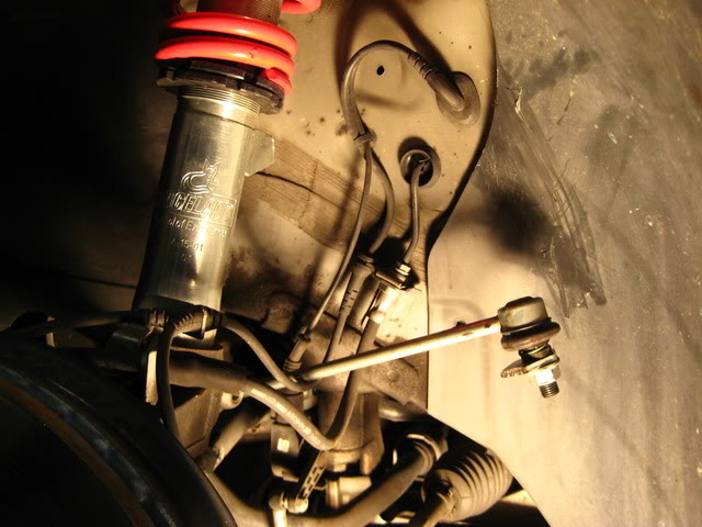

I'll add that I would never put raceland or rokkor coilovers on my car or even ride in a car that had them, not only is the ride terrible, but the quality is so low I would call them dangerous. They aren't like a $30 DDM HID kit that fails and its a bit dark in front of your car, if they fail you do severe damage to your car guaranteed. There's a reason why every other brand of coilovers starts at $900 and quality ones are easily $1500.
I would just get tokicos and springs or save a bit longer and get Megan coilovers.
Tie rod sheared off a raceland coilover, if that happened while driving you would lose the ability to steer.

hun, i gave another search on RL and RK's - actually the ones that know better, feels them bad. found another 4 that did break or fell apart - not sure if the one that fell apart was product or install, though.
