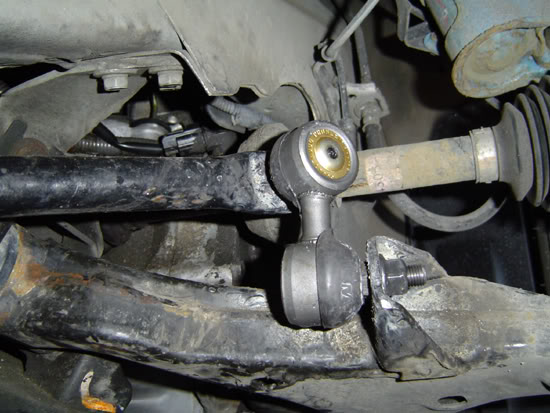

as a reference, follow a moog swaybar endlink picture:

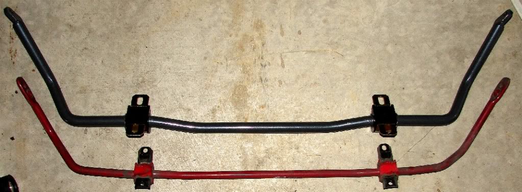

another data point.
Rear progress sway bar vs eibach (eibach is already larger than stock...)
Progress works wonders in cornering.
gray/Black in pic - progress
red - eibach
