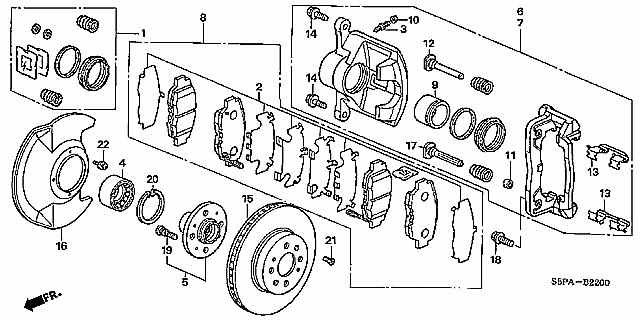

hey all.
question to all who know:
question1: is the ABS teeth/sensor on the 7th gen civics apart of the hub?
question2: are all civic 01-05 hubs the same?
because 44600-S5D-A00 is the part number for the hub for ALL year civics 01-05 EX/LX/DX
it is part #5 in the pix:
thanks guys.

Re: civic WHEEL BEARING and HUB question
Q1: The teeth are on the axle housing. The sensor is separate from everything, its bolted on. $45 from the dealer, just replaced my passenger sensor last weekend. (01 ex)
Dont know about your second question.
Ya the teeth is on the axle and the sensor is just bolted on to either the strut or knuckle I forget which one. Not sure bout your second question but if they all have the same part number then I would say they are the same thing.
For new ABS rings you need #1: http://www.bkhondaparts.com/billkay/...itch=&hidIrno=
For new sensors you need #s 14,15: http://www.bkhondaparts.com/billkay/...itch=&hidIrno=
Yes, all front hubs are the same from 01-05 except SI. I literally looked at every single model from 01-05, same part #. I was bored. lol.
