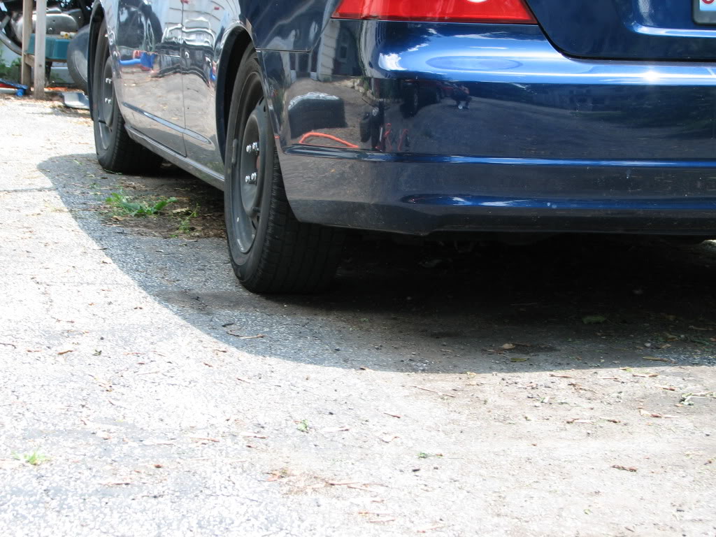

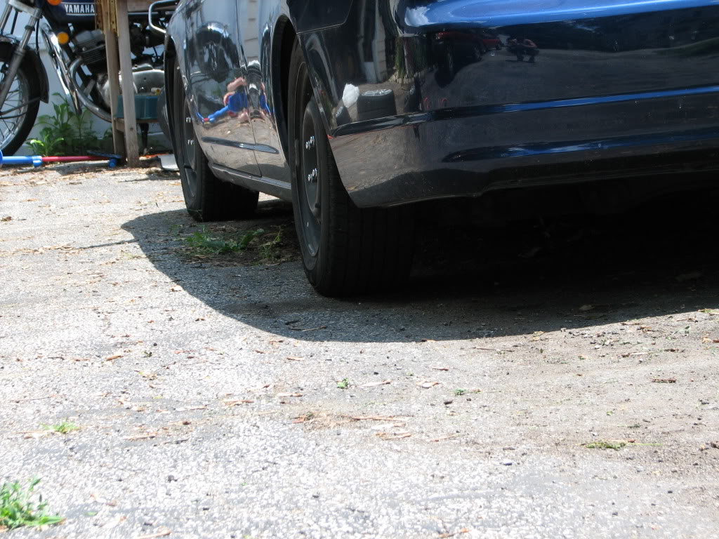

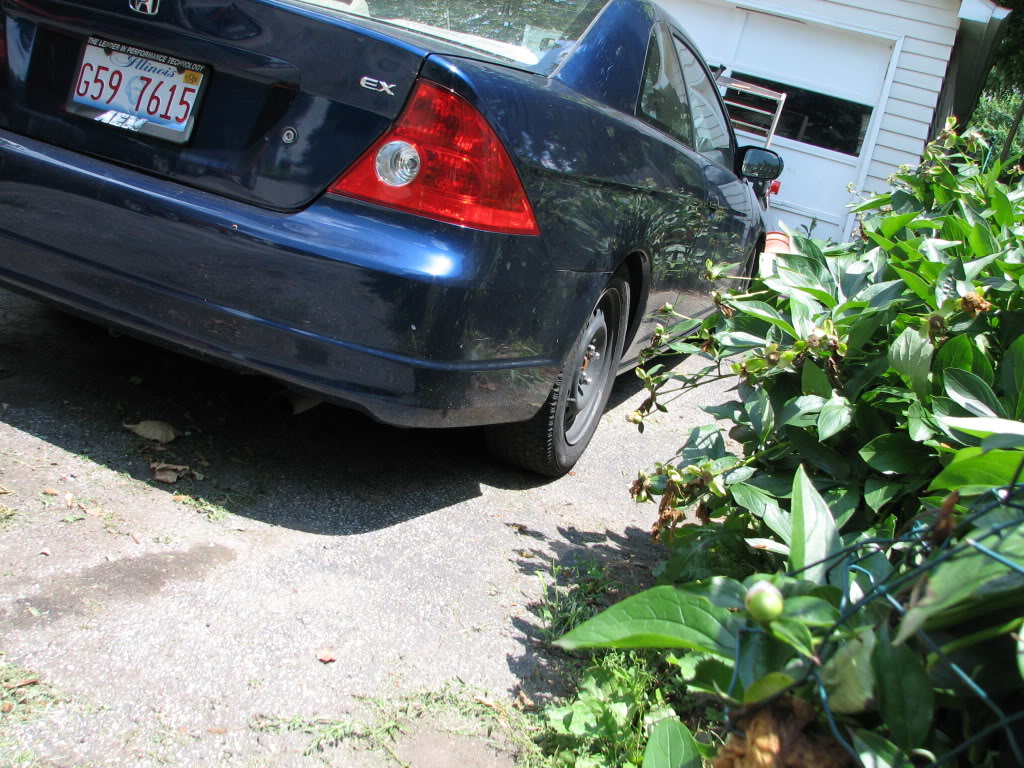

Am i going crazy? My rear tires look like they are slanting in all crazy. I have ground control coil overs on the car. They were on there when I bought the car about two years ago. Im no mechanic but im not an idiot either. Can the coilovers do this over time? Does it mean I need new suspension?

your in need of a camber kit and it'll fix you up.

what i dont get is why did it do this all of the sudden? These coilovers have been on there for at least two years if not longer.

it just happens over time. The camber kit stops that from happening but I guess your lucky enough to not need to for that long or you just didnt notice it until it was pretty major.

its called sagging it happens with cheap coils over time get rid of those ebay coils. i would get ingalls camber kits front and back. if you can use a wrench you can put those in.
