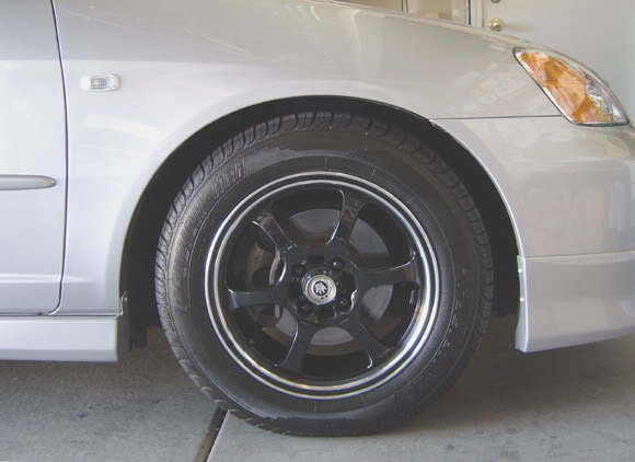

heres a pic of my prokit drop with aftermarket shocks, 15 inch wheels, and oem size tires.

Looks nice!..Thats the exact drop i want with my 17s. Theres no way i can spend ~$1000 for aftermarket shocks, thats why i was wondering about just aftermarket springs, but im not gonna risk messing anything up. Looks like im staying at stock height unless i can find a deal on some used shocks somewhere....keep an eye out 4 me haha
