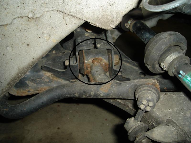

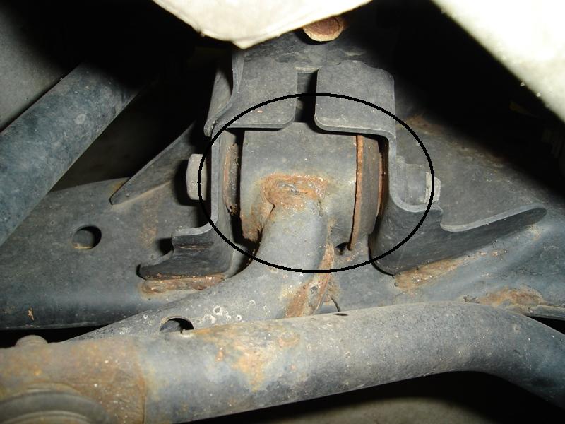

For starters: I'm using Tein H.Techs with Tokico blues that have been installed for a couple months. Recently I've noticed a creaking sound from the FR strut at low speed while turning. So we pulled the tire to have a check and tighten everything up. Everything was still bolted to spec but we noticed what appears to be some severe wear on my lower control arm.
We pulled the front driver side then and the wear wasn't nearly as bad. I've attached pictures (the passenger side is the first pic) and am looking for any advice. Replacement arms appear to be about $110 from parts.com (#11 I think).
Thoughts?

That is NOT severe wear on the bushing. If anything, the other bushing is shittier. Why would that bushing make noise while you are turning? It moves up and down, not around.
There are a few causes
1) The spring bearing up top, which everyone else said.
2) Your ball joint(s).
