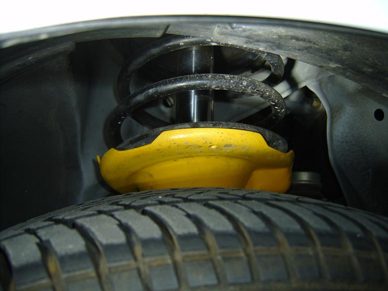

Old Mar 21, 2008
dopes6070's Avatar
iTrader: (25)
Posts: 1,834
From: Orange County, CA (714)
Rep Power: 301
dopes6070 has a reputation beyond reputedopes6070 has a reputation beyond reputedopes6070 has a reputation beyond reputedopes6070 has a reputation beyond reputedopes6070 has a reputation beyond reputedopes6070 has a reputation beyond reputedopes6070 has a reputation beyond reputedopes6070 has a reputation beyond reputedopes6070 has a reputation beyond reputedopes6070 has a reputation beyond reputedopes6070 has a reputation beyond repute
Re: Bilstein sport struts review
Ok here ya go...
ID:	73911   Click image for larger version
Pics up
