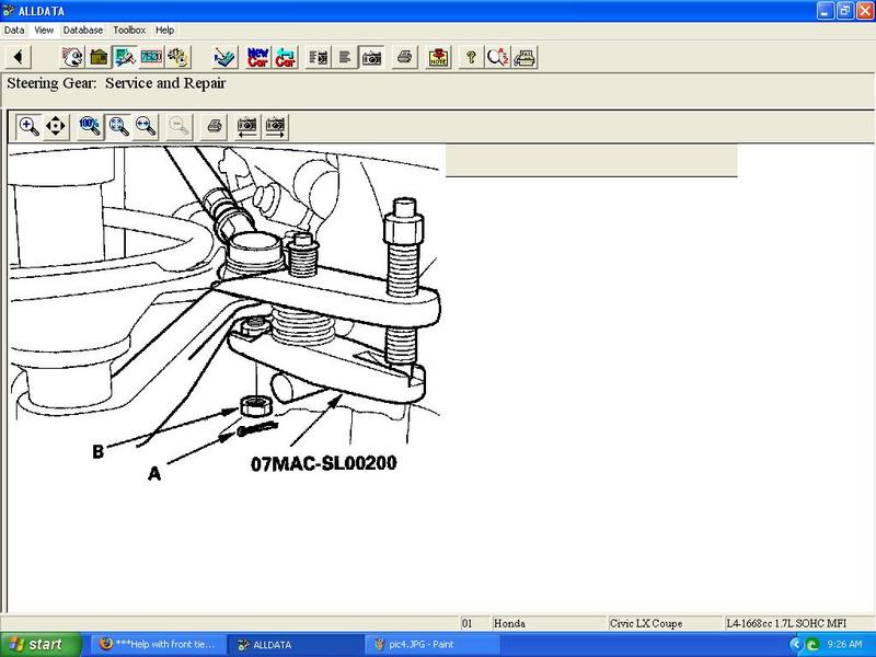

Here is the tool you are supposed to use...
or using a hammer hit the side of the strut where the tapper is and the tie rod will pop lose. DON'T hit the threads of the tie rod!!!!!

Pick up the tie rod seperator tool to make it easier on yourself- usually can be rented from auto stores for cheap. If you cant find one, hit the strut's arm with a good 30-40 wacks from a hammer and it should come out. But dont hit the threads on the TRE if you plan on keeping it because you'll never get the nut back on with all the mashed up threads. I speak from experience.
