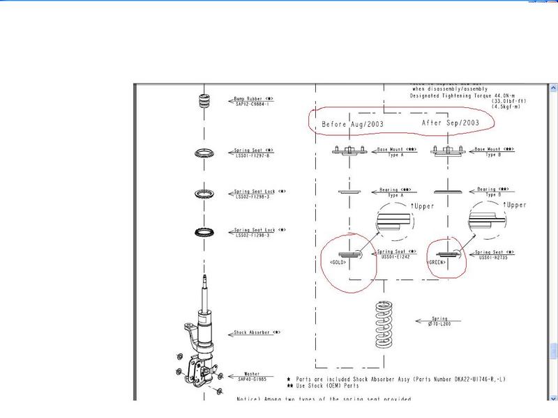

Old Jul 2, 2007
TemjinX2's Avatar
Posts: 4,576
From: Lakewood, 562
Rep Power: 320
Re: Are there any pieces missing to these Tein SS coilovers ????
Originally Posted by speedfoos
My car, and the Teins, are US spec. So am I for that matter. I have the SS setup as well. The Basics are different than the SS ones. Hence gold rings.
I assume you were from the UK since your location saids UK on it. The way the Tein ss and basics mount are the same. I glad you were able to do it with yours. I dont know how you did it, since i had 01 mounts and the spring seats wouldn't fit into the green rings that well.
Page 9 of out the Tein SS manual.
Manual > you
link
http://www.tein.com/ti/inst/ka22u.pdf

Old Jul 2, 2007
speedfoos's Avatar
Joined: Apr 2006
Posts: 5,217
<shakes fist> Damn manual.
Guess I'll have to take my suspension apart again and paint the rings green so my car will go faster. They've been on the car since August of 2003 so that may explain the gold rings though. Either way, hope you get what you need 5.0 and sorry for any confusion!
Old Jul 2, 2007
TemjinX2's Avatar
Posts: 4,576
From: Lakewood, 562
Rep Power: 320
lol...
yeah it saids after august of 03 or sept of 03. So your car was the last set before they changed the mounts.
