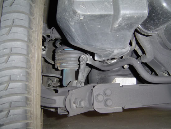

Re: Rear Sway Bar
heres what it should look like installed the right way.
