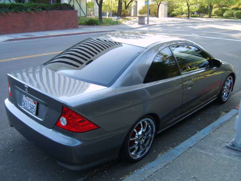

Iv'e been searching alot and I'm stuck in a between getting bilstiens or getting a really good coil over system with upper pillow mounts,I've looked at b and g, jic,h and r, practically everything.
my car has neuspeed sports spring
neuspeed front strut bar
neuspeed x-brace
carbing lower tie bar
front and rear energy sway bar bushings
My shock or coil over has to be really strong because my wheels are like 25 pounds each
another reason why i wanna get a coilover system is because I bottomed out a few times wit my car and chipped some paint off the front neuspeed spring
I also attached a pic.
