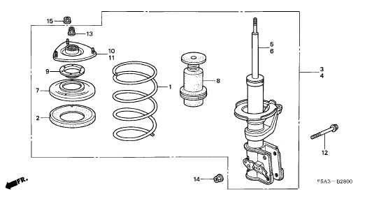

When I installed my B&G Coilovers I had to buy 2001 upper mount bearings. That's because I had a 2005 and the coilovers were made for 2001.
The 2001 is shaped like a circle were it meets the coilover and on the 2005 it was shaped like a triangle if I remember correctly. Since they are not shaped alike they will not fit correctly. Maybe that's the problem. Hope this helps.
you wouldn't happen to have any pics of the 05 bearing. i just want to see the difference

I don't have any pics of the 05 bearing. Check this link out. http://gametrax.net/b+g/ This link has pics that compare the differance how the 2001 upper bearing to the 2002-2005 bearing and explains why 2002-2005 will not seat properly on a coilover made for a 2001 Civic.
If your coilovers were made for the 2001 and you have 2002-2005 then you'll need part #10 and #11 and quanity of two for part #9 from a 2001 Civic. You can get them at your Honda dealer or order them online at http://www.hondaautomotiveparts.com. Hope this helps.

ok this is absolutely the problem. I did jack up the car, and i've seen that the bearings sitting on top of the springs is lose. There is a lot of room for the bearings to move around.
I mean, when i order this, it clearly states that it was made for 2001-2005. I guess we're gonna have to take it out with Dezod on this one.
So we need parts #9, 10, and 11?
Looks like we just need #9 tho. We know the bearings are different. Is the strut mount different too?

This is probably 99% correct. These coilovers need to be indexed otherwise the clicking and popping will occur. That has been the #1 mishap on installs of these coilovers.
Furthermore, if you have a metal bearing in the 04-05 models, you MAY need the plastic version, which is Progress Part # 66.0102 or Honda # 51726-S5A-004, which is about $14.
