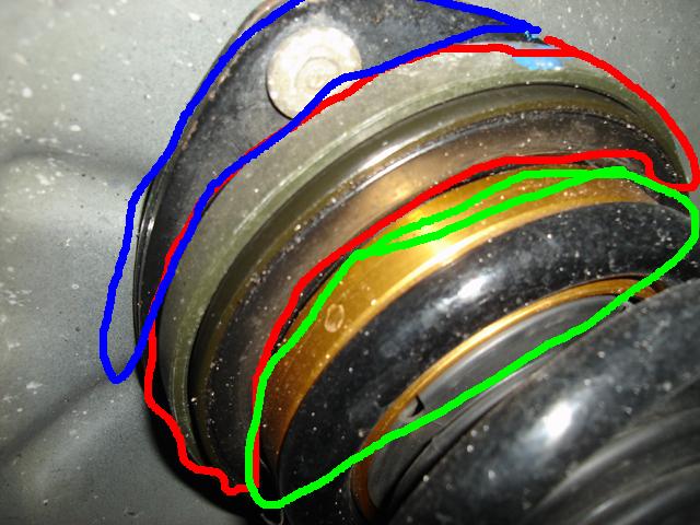

WILco! im gonna take a rim off and take a picture of it right now see what the hell is going on under there
Old Jan 3, 2006
ruffryde009's Avatar
Joined: Dec 2004
Posts: 904
Rep Power: 273
ruffryde009 is a name known to allruffryde009 is a name known to allruffryde009 is a name known to allruffryde009 is a name known to allruffryde009 is a name known to allruffryde009 is a name known to allruffryde009 is a name known to allruffryde009 is a name known to allruffryde009 is a name known to all
hey I took some pics!!! hopefully this helps you guys help me out :-D
according to the diagram everything looks good!

Looks like you have two of the gold rings up there instead of one, however I'm not a pro so I'll leave it to Axxe to decide what's wrong. He knows his ****

thats what I thought but on the diagram it looks like it that 2 layer I have also

Holy ****. No wonder you can't lower it anymore. It appears to me that you have your factory upper spring perch sandwhiched between the ring and the upper strut mount.
Outlined in Red is the factory upper spring perch, it needs to go.
Outlined in Blue is the upper strut mount, it stays (mandatory)
Outlined in Green is the adapter ring. It is made for the early model uper strut mounts. Check the Tein diagram when you remove your upper strut mount to verify the type of upper mount you have. Gold is for early, green is for late.
Good luck, post pics of the upper mounts if you are not sure which ring to use.

wow thanks for the reply!
I will try and see if I can fix this as soon as possible
and no.. no noise at all and a very good ride... close to stock but with much better handling
