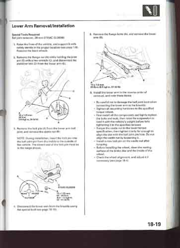

Originally Posted by vietstylez
yeah but with labor etc.. it could get up to 200-300US
Why have some one do it? it is so simple here are the step by step directions.

The part is only $73.00 from http://www.hondaautomotiveparts.com
Also if the image is too small i can send you a bigger one.

yes i plan on doing myself and yes please send me a bigger version! thanks a lot man
