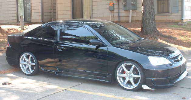

I would definately get good coilovers over any spring. Having a kit, made it impossible for me to get my car on a lift at pretty much any shop. Now that i switched to tein super street coilovers, i can adjust the height in about 10 minutes and be ready to get maintenance done.
