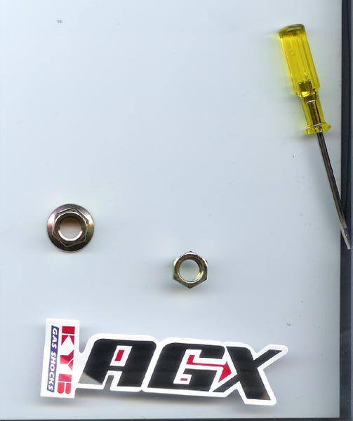

anyone with KYB know what the two nuts that come with the fronts are for??
and witch setting it the hardest 1 or 4????

The two nuts that come with the front are supposed to replace the stock hardware that holds the strut assembly together on top. You'll notice they're nylon lockers, where the stocks are just plain nuts.
I have to say the best part of the KYB AGXs so far is the abundance of small screwdrivers i'm left with after the install.

well this is what i got only with the fronts, and the nuts donrt have nylon, so they installed them with the stock hardware...
