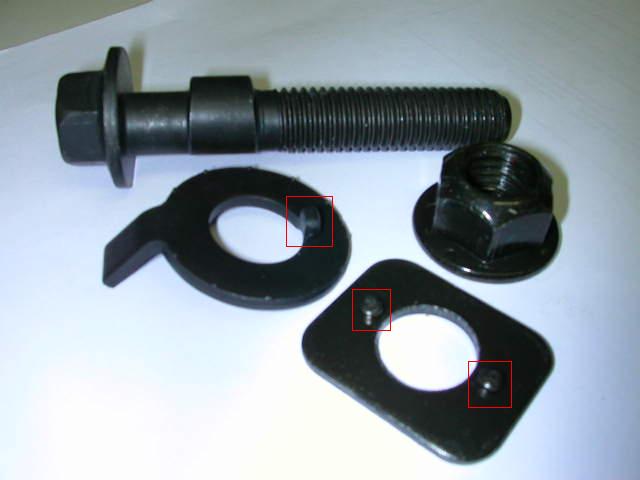

There was something else that I wasn't able to accomplish though. The SPC Front Kit doesn't fit. At the shop, they said it was impossible to installed them without actually modifying the strut holes again. WTF?!!! I may have the wrong SPC kit. Damn it. The strut holes have to be oval in order for the plates to fit, according to the mechanics.
What is this plate for? First they sent me 14mm bolts, then this kit, now what??!! I don't understand its design. Couldn't it just be just like the first one they sent me, but 16mm and without that plate? It'd really suck if I can't install it.
I guess I have to search again.

I think your shop mechanic is wrong. You see that eccentric on the cam bolt? That eccentric when inserted between the two bolt holes pushes the strut either in or out to correct camber. The holes on the strut do not need to be ovaled, if they were the eccentric wouldnt be able to do its job.

your mechanics are idiots... the cambolt has an ecentric lobe to allow you to adjust camber.... thats why its oval!! the washer with the tab goes in one way and that forces the eccentric lobe to either adjust for more or less camber, depending on the side the tab is on. they are a bit tough to get in, but they work. the only problem you may run in to is that they are simply the wrong size. (Remember Honda did change the bolt sizes..)

Originally Posted by cubanmike26
Racing eh? Must be nice... I wish we had a track down here, but the closest one is 200 miles.
Oh well, I still got the road
Any idea what that rectangular/ square washer with the studs is for ?

That's what I'm refering to GaryC17. Where does that go? Back when I was sent the wrong kit(for 01-02/ 14mm), it was only the bolt, the washer & the nut. Shouldn't the ones for 03-04 be the same but simply 16mm? I'll look at the instructions tonight. I think it mentions something about installing this kit only on struts that are modified.

Great news!! I talked to a rep. at SPC and he said that rectangular piece only applies for GM vehicles.
Well, that's a relief. I guess I should have called them first and would have solved this problem a long time ago. So like I said, that piece with the tabs is not nedded for our civics.

GM vehicles? Why would they ship that with a Honda part? I'd call back and double check..

The SPC kits work with a wide range of cars, so they include those plates for our cars too.
