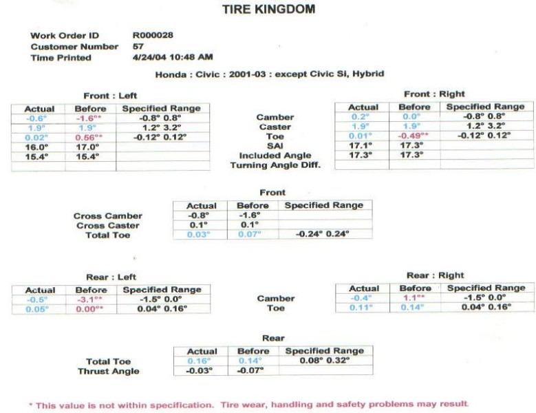

here is my alignment sheet from yesterday when i got my 3rd alignment down at the tk performance in downtown cleveland. it shows that everything is in the correct specifications, but it still drifts right? anyone know what the problem is?

see where it says cross camber -.8 degrees? that .8 camber lead to the right and of course it will pull right. Just cause its green on the alignment machine dont mean it will drive straight! take it back and tell them to correct the lead to the right in camber. If anything you would want a little lead left in camber to compensate for road crown. Hope that helps

means yes it needs aligned by someone whom knows what they are doing
