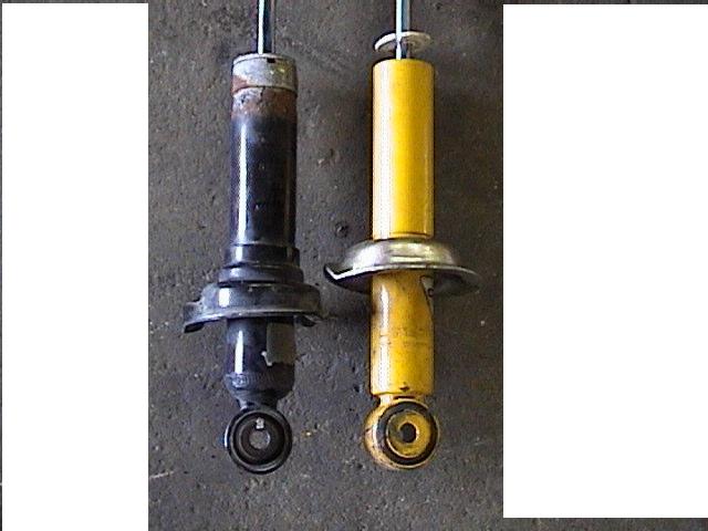

Yes, it's on the lowest perch and everything. And yes the springs have settled, but check this out. Notice the Koni perch is higher than the factory shock. Don't get it. I'm asking koni about this one. Anyone else with this problem??

sorry about that, check the difference b/w the factory and the koni's perch heights

That looks like it's on the higher perch.
This is where I HAD to set mine to keep my tires from compacting the fender lip during normal suspension travel. Had the ICE put in the trunk (phase 1) and it lowered the rear of the car a good inch. Then I installed the Konis and set them to the higher perch, and things were back to normal. . . perhaps a little higher. This is all because I thought it'd be a good idea to have over 150 lbs of custom work done back there.
Anyway, the Konis are MUCH more firm (especially on the firmest setting, duh) and my suspension travel is well within the specs of what I need it to be with the wider wheels and tires.
Adjustable perches = GOOD.
