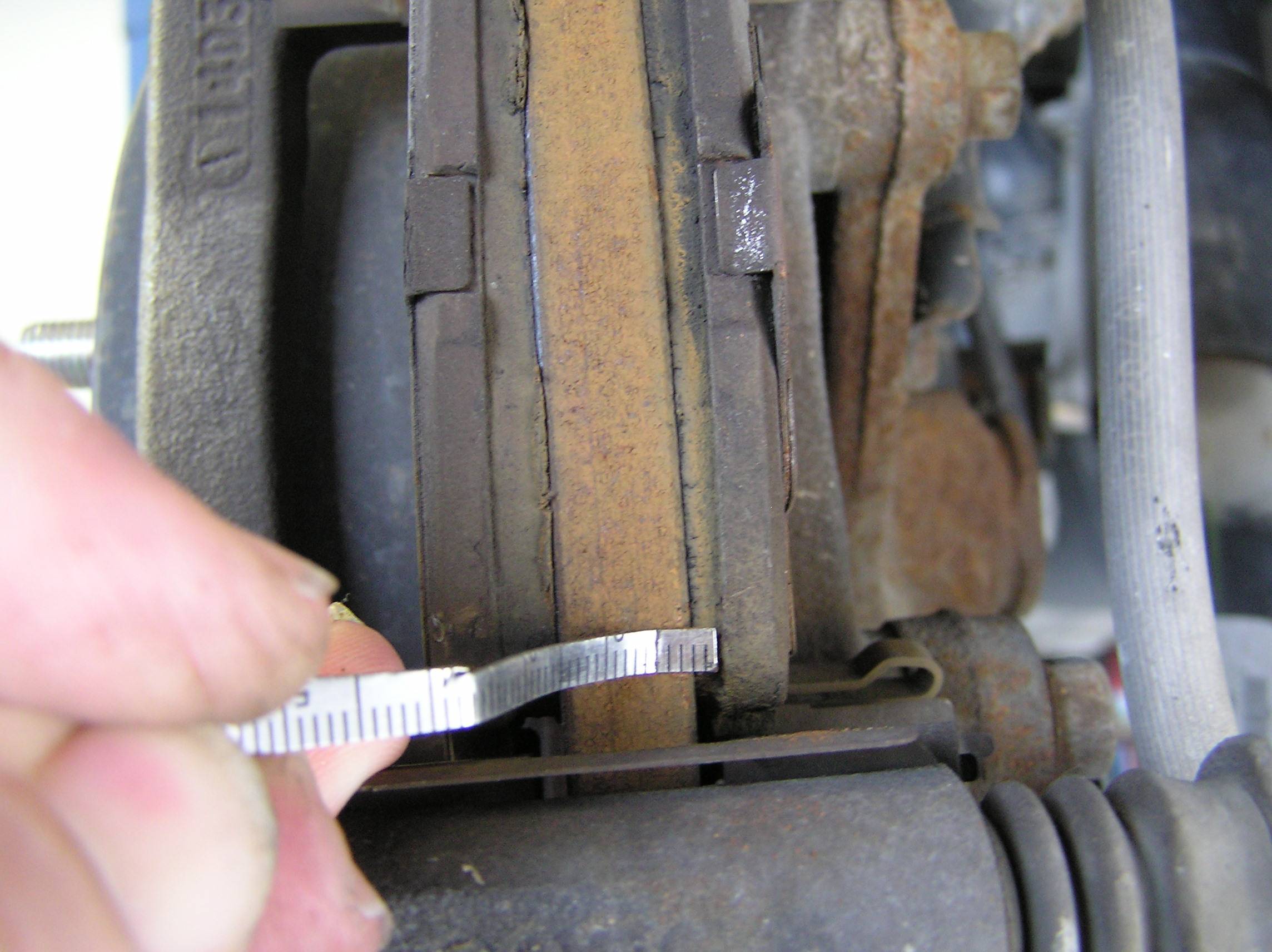

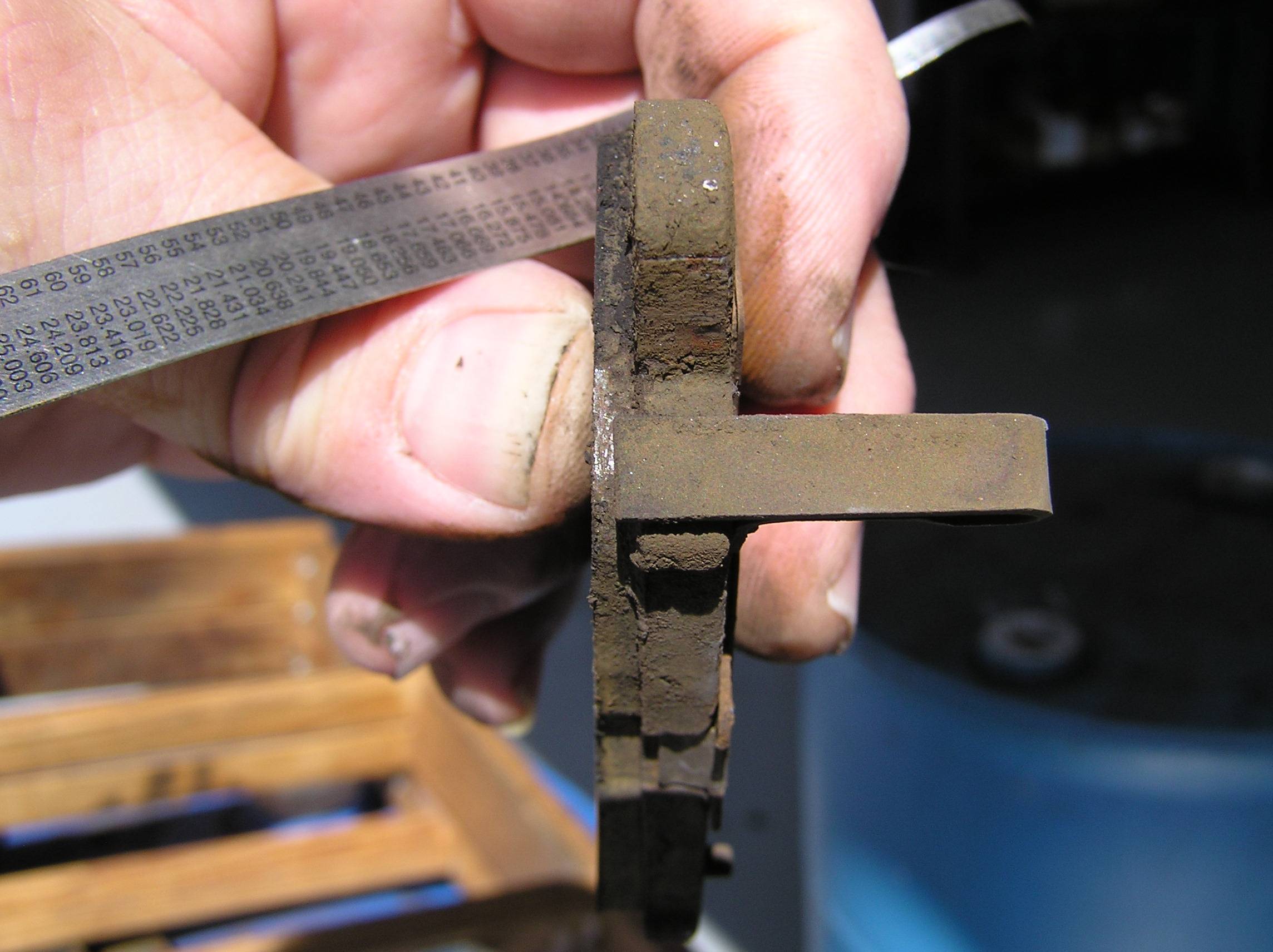

Actual pictures of actual measurements of actual Honda (might be from an Accord?) brake pads in an actual shop:
I sure did try to sell a brake job on this car......
First pic is taking a measurement with a cut-off steel ruler, you can see this one has about 2mm of pad material remaining (always measure the thinnest part of the thinnest pad of the set, that's the one that counts most!)
2nd pic shows the wear indicator and you can see it should make contact (and therefore make noise) when the pad wears to about 1mm thickness.
