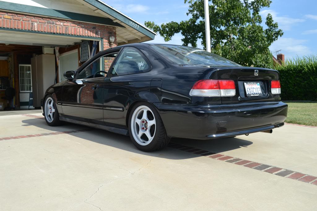

Those rims in the picture you posted appear to be Varrstoen (Volk TE37 replicas). And they are definitely 17s......probably 17x9s +30 if I had to guess.
The simple answer is, you won't be able to get that fitment with 16x7 +38 wheels, unless you use a big fat spacer. And, you will also need to be lower than 2 in.
Here's my car in 16x7 +40 Rota Slipstreams. You can see the wheels tuck a good bit (this was before I corrected the camber).
As far as wheel choices go.....the Volks will be the most expensive. But they will also be the lightest and the best quality. I do also like Buddy Club P1s.
If you want fitment like the picture you posted do research......you'll need coilovers, camber kits, fender work, and will also have to stretch you tires, something I'm not fond of.

I just realised the tags state they are 16's... my bad. tires are 195x40 stretched. It's slammed that why it looks that way. How many inches would be slammed tho?
http://www.ebay.com/itm/16x8-Varrsto...-/331099634577
These are the rims !!! The offset is 25mm...
