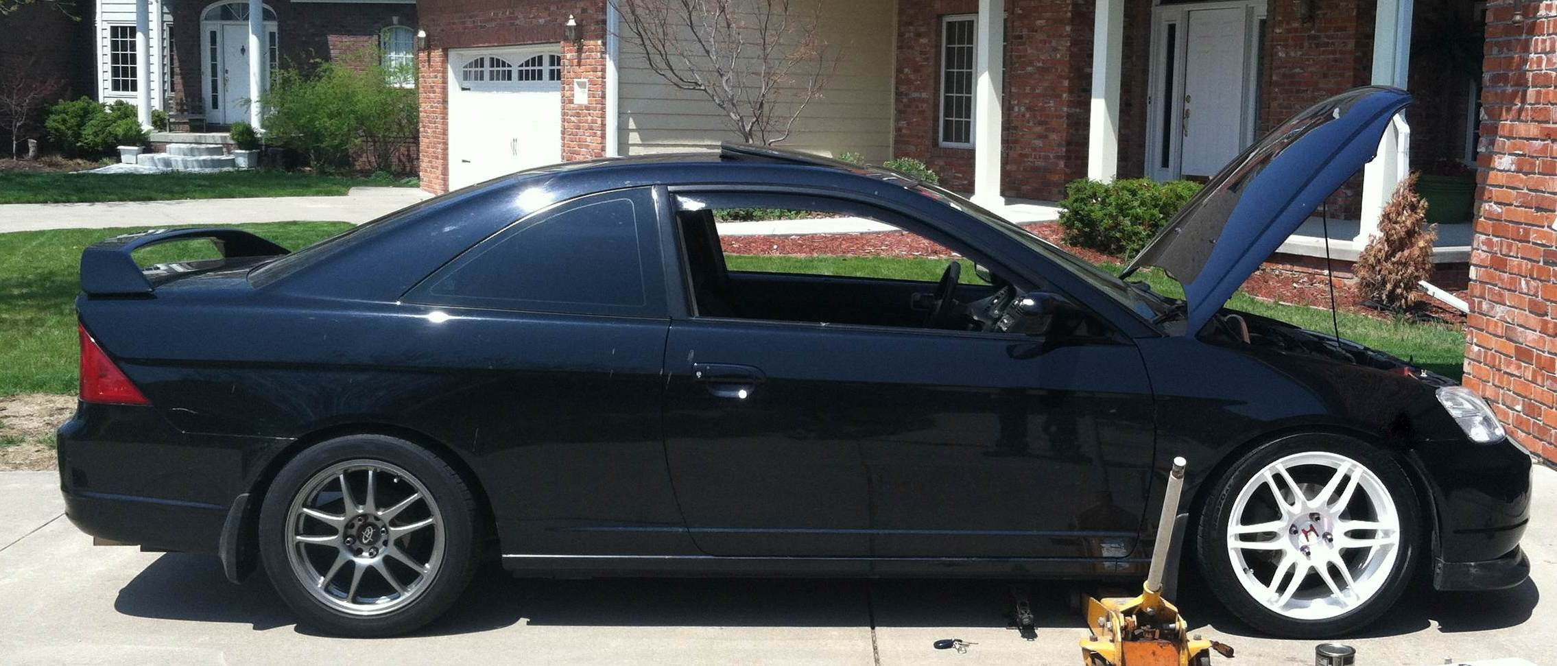

^ I agree. Im not a fan of black wheels on most colored cars because the wheel blends in with the tire.
White looks great on a black car
You could always get the black wheels, see how you like them then get them powder coated to white or any color you want. The white wheel in that picture started out as black and he got them powder coated at a local shop for $190. That is always an option to!
