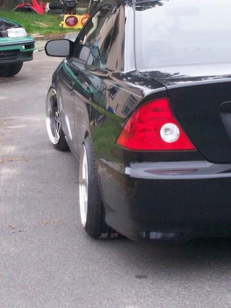

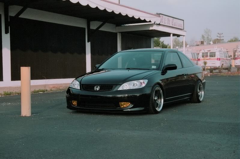

i actually like the staggered look 16x8 et6 front 16x8.5 et10 rear
ID:	83394   Click image for larger version
