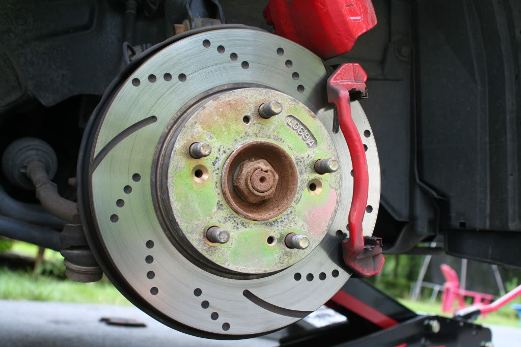

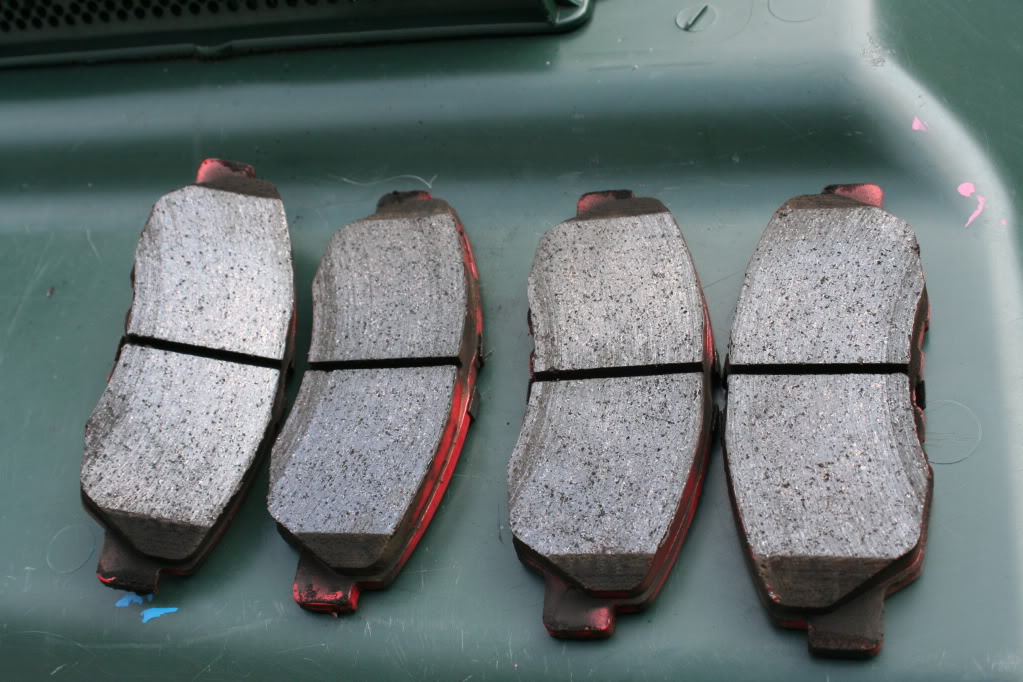

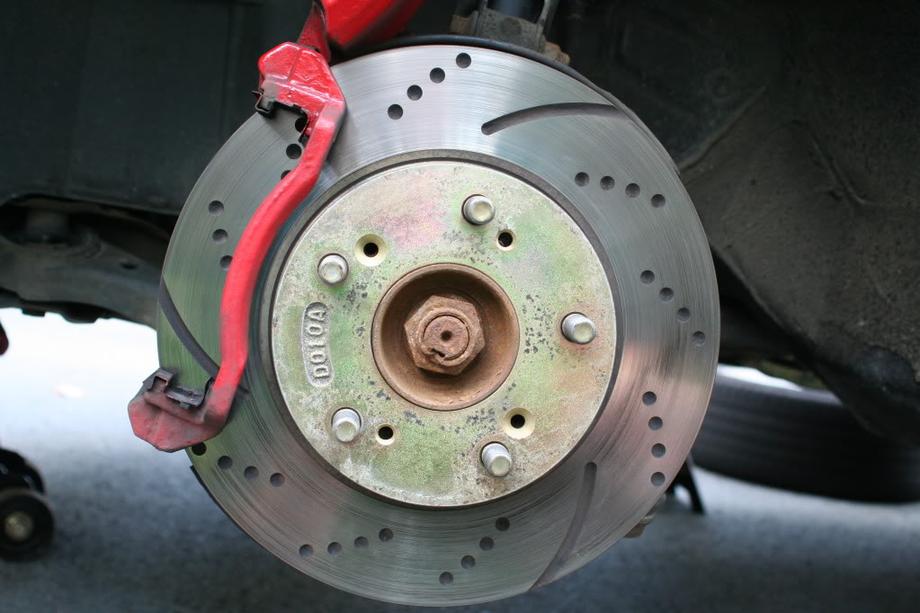

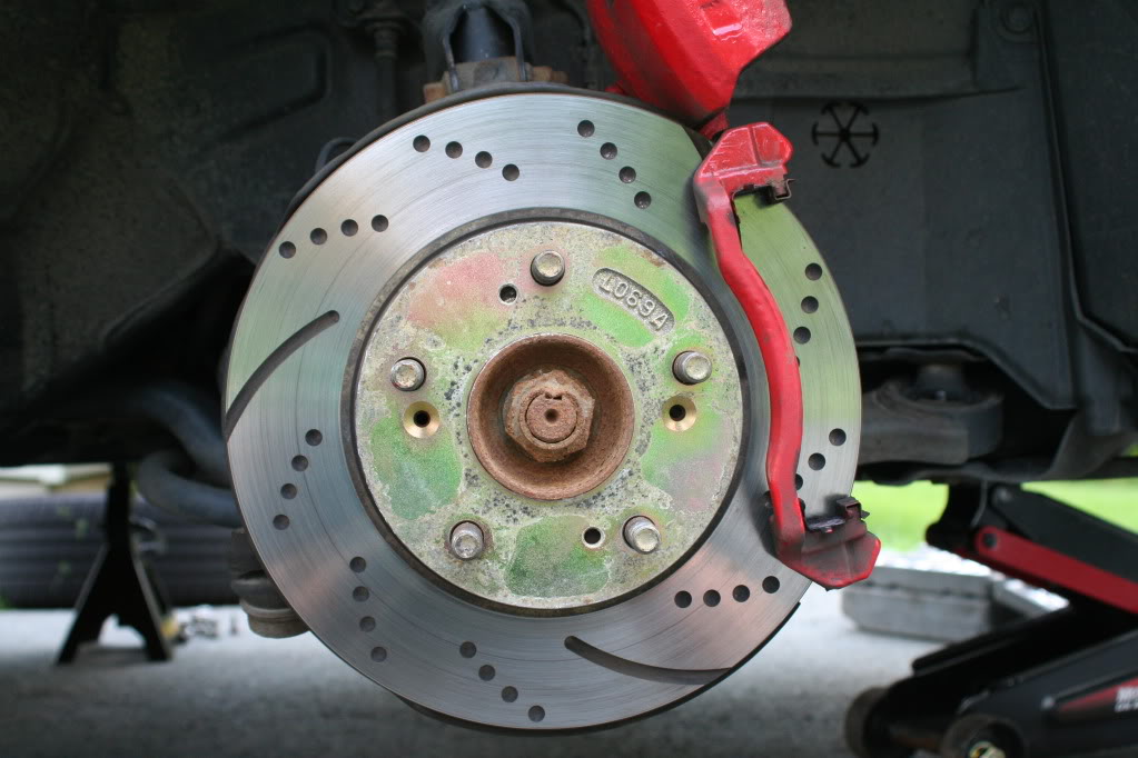

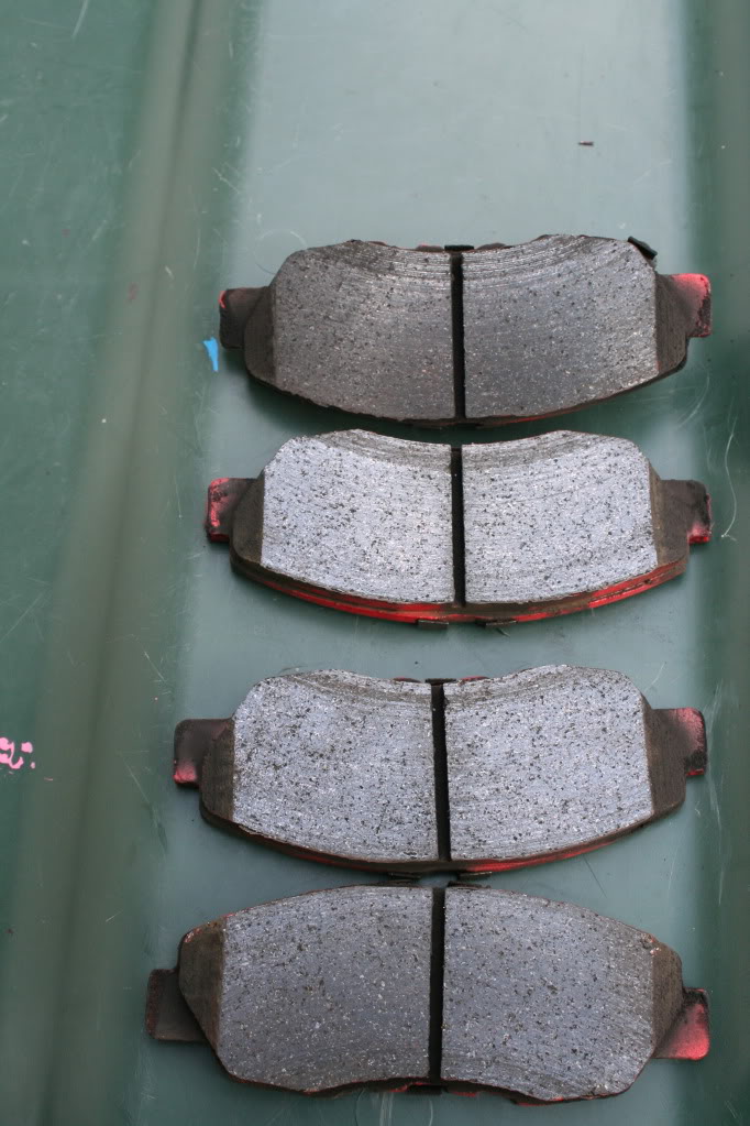

Here are pictures of the rotors & Pads. They have 5000 Kms on them. I notice a little black streaking on the left, and a small groove on the right. Also, on the pads, there was a rough edge all around them, I think from the break in coating that was all over the pads when new.
The wheels are always torqued 80 Lb/f
Because my old rotors were warped, I researched causes, and one thing I do now is when I come to a stop, I leave a car length ahead of me, and I inch up a little at a time so that the pads are not in one spot for long at a stop.
Left Front:

Right Front

Pads (Right Inside, Right outside, Left inside, Left Outside)

Pads

so you never sat on the brake after stopping with these? in that case i think you just got too hardcore of a setup. technically this should only be used for racing, or if you use the brakes a lot coming downhill from a mountain. the rotors are a mess, that is pad meterial all over because they are just too aggressive. they are not reaching their operating temp (and likely never will unless you routinely make 60-10 stops on the freeway), and as a result it looks like the pads have not even broken in yet. im not sure about your stopping power, but i cant imagine its any good. i think you wouldve been fine with oem hardware to be honest, they are setup for the street and so long as you dont keep your foot on the brake after stopping, they should never get messed up.
you can fix the ones on there now by doing a bunch of hi speed braking and hope the stuff will get cleared off the rotor, but idk. its hard to tell. could also do the bedding/burnishing procedure which requires about 10 back to back near stops from 90-0 i believe. may want to look it up, but there is prolly no way you will get to do it properly unless youre on the freeway by yourself.
